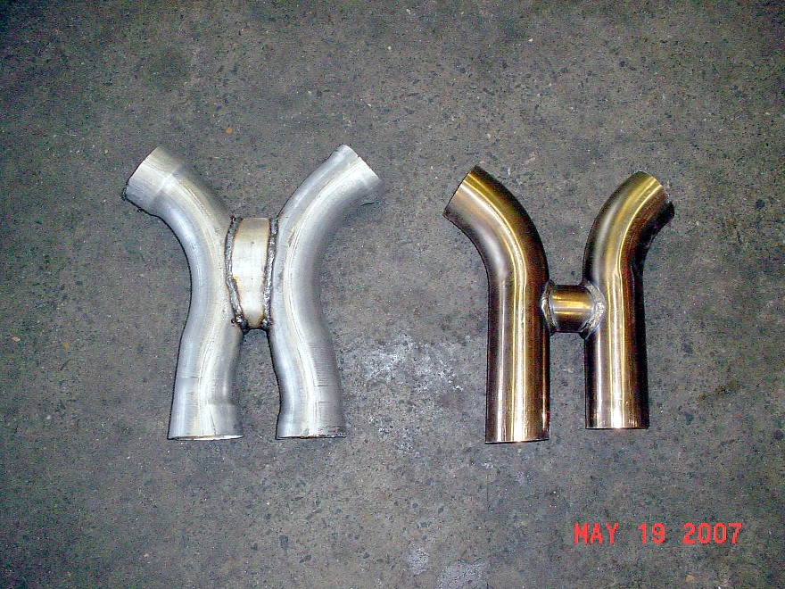

Old Jun 21, 2007 | 11:19 AM
gothchick's Avatar
gothchick
Posts: 3,300
From: ATL
+1 on the X-pipe mod.
Here's a custom fabricated X-Pipe on my HKS Hi-Power. Much better design than the H-pipe it came with...
