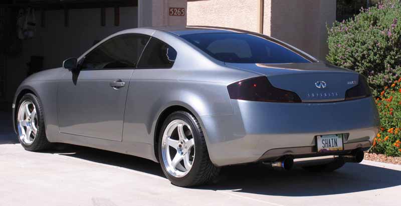

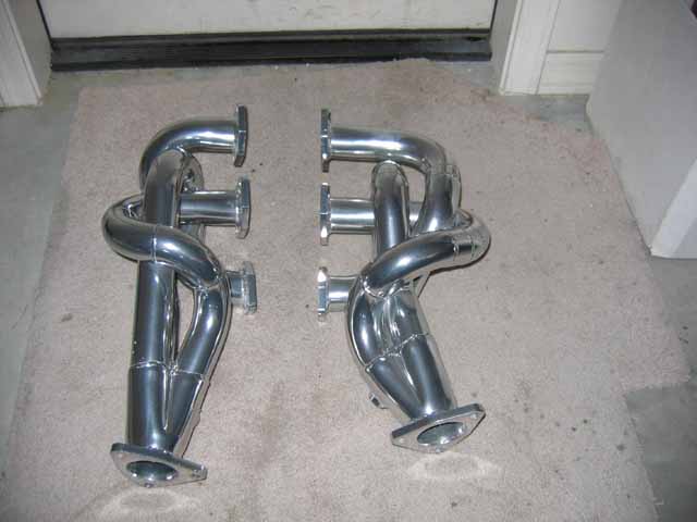

You simply don't know what you are talking about My Crawfords made the biggest difference in power than any of my other mods. These headers IMO, are great. I am attaching a Dyno chart taken minutes apart comparing my Coupe to an '05 with the Rev-Up engine and a plenum spacer.
My Car is the blue line, the Rev-Up is the red line.
My exhaust sounds great and is made up of The Crawford Headers and Hi-Flow Cats and an Invidia G200 exhaust with an "H" Pipe.

I know EXACTLY what I am talking about. My car dyno'd only 8 hp higher than one of my other friends who didn't have headers nor an aftermarket exhaust. In addition, his car was an automatic and mine was a manual. That could've been the difference right there.
Maybe you had better luck with your headers but overall, headers are STILL a HUGE waste of money as there is very little noticeable gain if any and you probably lose torque. When you think about it, it doesn't really matter the size of the header tubes because the holes in the block leading to the headers is still the same size. In order to maximise header gains, you need to bore a bigger exhaust holles in the block to match the headers.
When going turbo, I was advised to stay with the stock headers as to maintain a certain exhaust velocity to help with the turbos spool-up. In addition, the material from the stock headers is very thick and sturdy and can withstand the heat better than any other aftermarket header which happen to be much thinner in cast.
You may have a nice dyno sheet but mine read 350 rwhp and 340 torque on mild boost settings. The friggin headers cost me over $1,200 when I got them. The turbo was the best power investment I ever made. Once again, headers are a waste and most can't even be utilised if to go with a turbo. The biggest way to get power on the exahsut side of things is to remove the cats and go straight through piping. It is the ONLY way.
That's not true. A LOT more goes into tuning a header than just the port size on the head. While that will have some influence on the tubing diameter, there's still other factors that will affect how much power the header will make and also where it will make the power in the powerband. You can change the primary tubing diameter and length, you can step the piping, change the collector size and shape, etc.... What do you here will also change depending on if you have cats, test pipes, single or dual exhaust, also what cams you run, etc... Header tuning is really an art.
The biggest problem in making a really nice set of headers for the g35/350z is the available space, that's why you don't see too many different designs.
