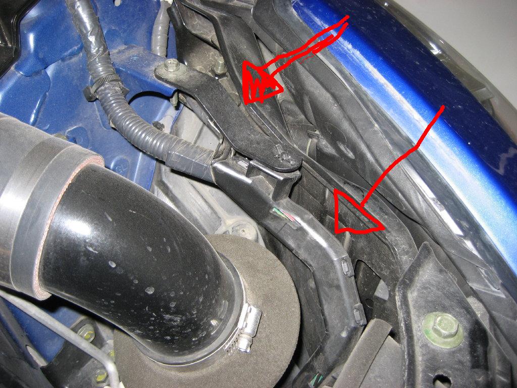

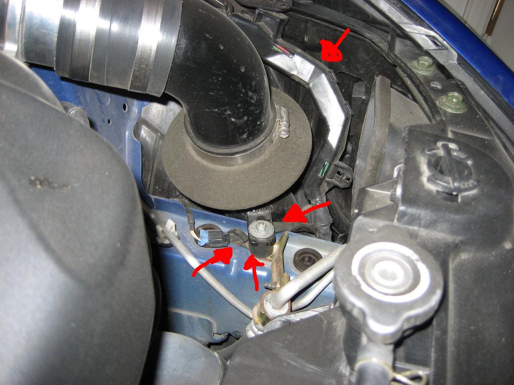

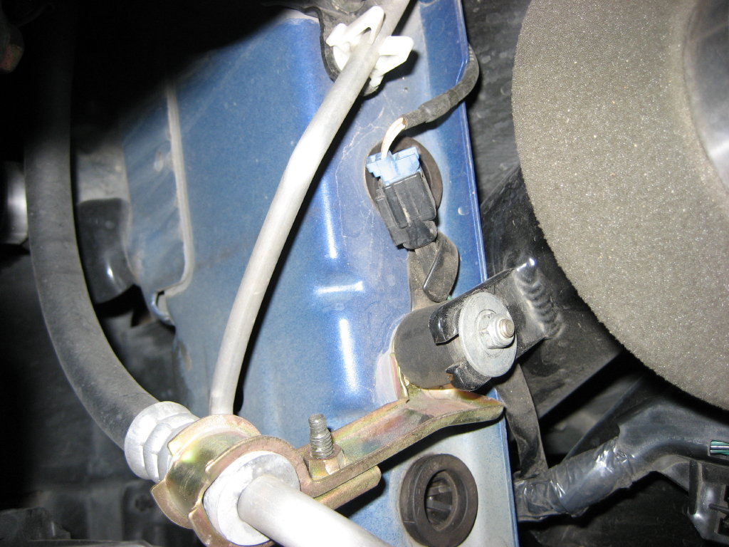

lemme take some pics for you
EDIT:
Parts 1, 2, 3, and 4 are visible in pics 2 and 3. Part 5 is under parts 1 2 3 4
in pic 1 and 2 you see the bracket and the cable line that is relocated
Attached Thumbnails Nismo CAI installation-7-2-003_1.jpg   Nismo CAI installation-7-2-002_1.jpg   Nismo CAI installation-7-2-004_1.jpg
