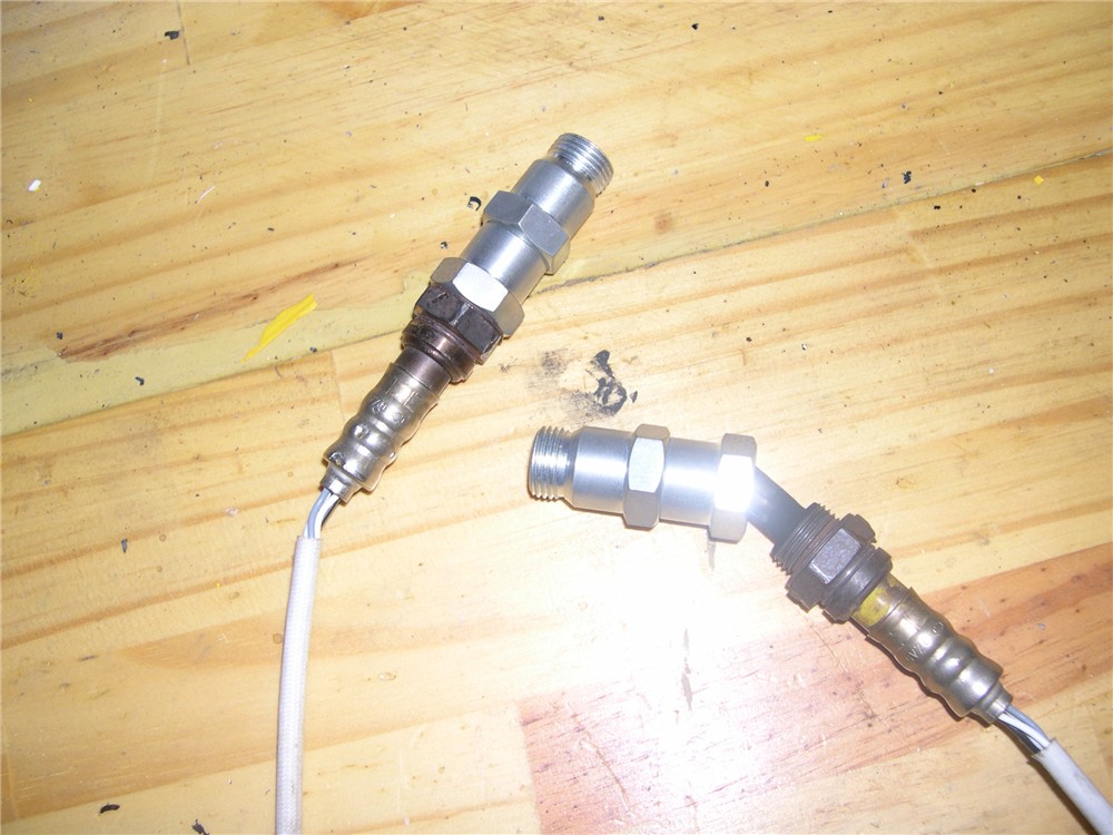

Looks like this.

Yeah, thats exactly what I have put on my o2 sensors, yet I'm still getting the CEL light.
