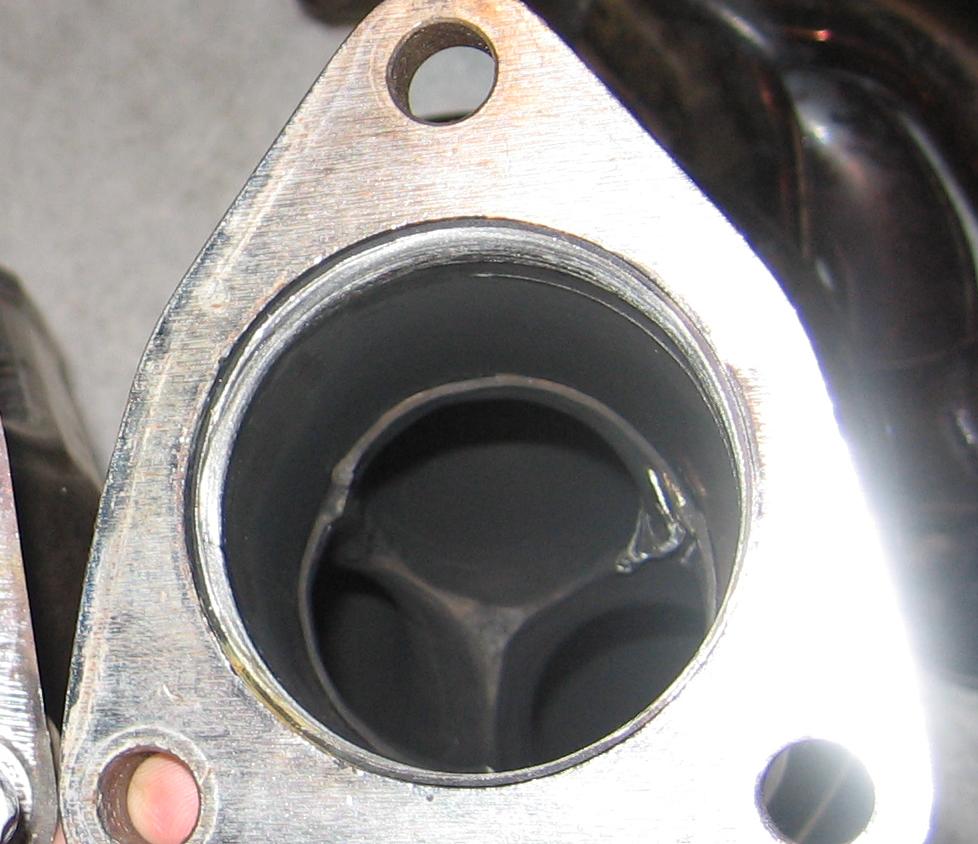

The inside of my Topspeed headers looked a hell of a lot better than those. I even blended a small weld.

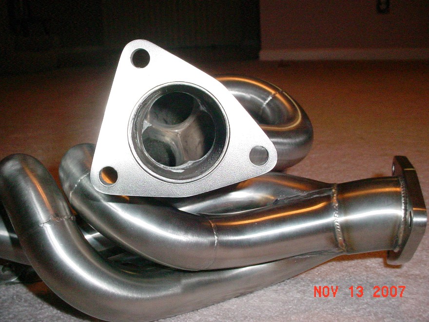

From: ATL
Here's what my DC Sports look like. Inside welds & flanges are among the cleanest I've seen. I got these from Kyle at Import Parts Pro - Totally cool guy, great customer service. :-)

Those DC look good as well. I had no Idea the inside of the strup were like that. Airflow at that point is critical and a bunch of uneven welds will really mess with the exhaust gas pulses merging. That is why I blended the aera I did on mine.

My strups looked like those DC's on the inside. Thats odd.
