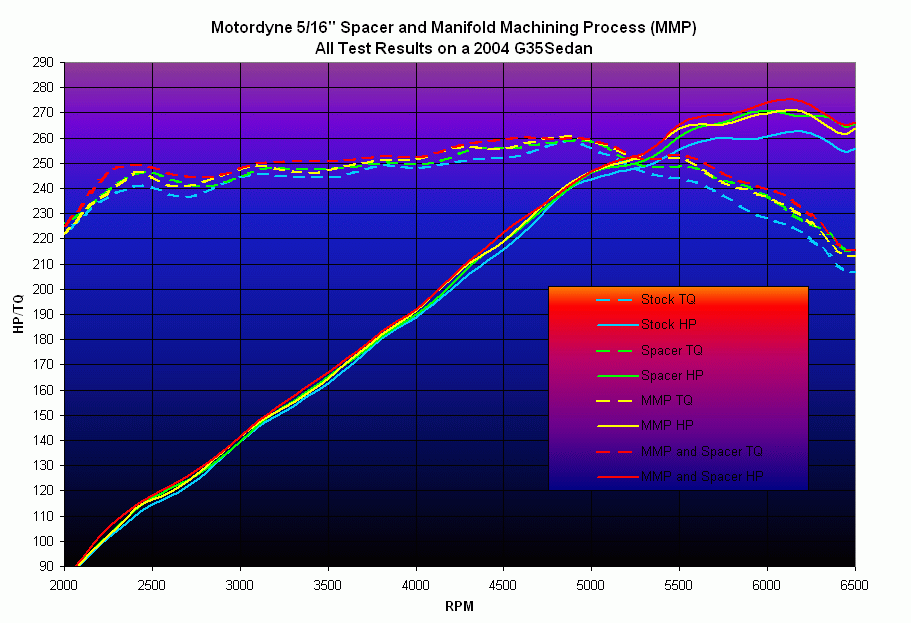

On a non revup engine that already has a spacer, the MREV2 will do another 4-6 HP. See the attached plot. In the plot it was named manifold machining process MMP before it was officially renamed MREV2.
The HKS exhaust will do about 12 HP on either the revup or non-revup.
The MREV2 on a REVUP engine will do a minimum of 15HP / 18TQ and often does around 20HP / 30TQ. http://www.motordyneengineering.com/...page_large.jpg
