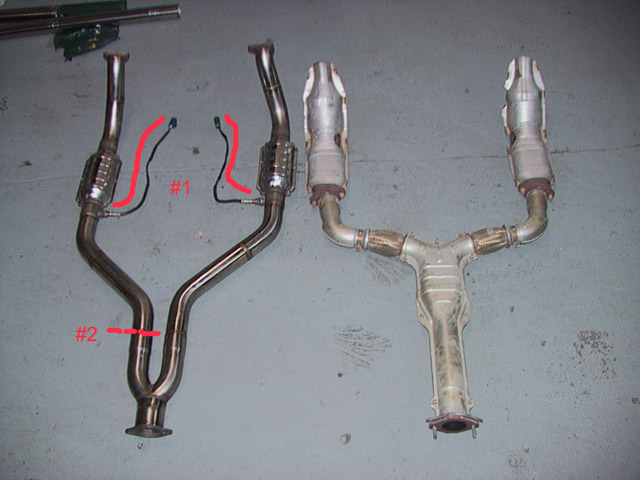

VFR350Z's Y-pipe is done. I watched them hand make it yesterday and we test fitted on my car to make sure it was a perfect fit.
Another note, take a look at this attached photo. They are your instructions for successful install.
#1. The photo depicts my O2 senors. You will have to modify them on your car for this Y-Pipe. All you have to do is lengthen the wires by 6 inches to make sure they reach with the new y-pipe.
#2. This is where both sides of the pipe meet at what is called a "U" Flange. For shipment purposes, we did not tig weld this joint. It allows us to ship the y-pipe in three pieces in a smaller box, reducing the cost to you. It will come with clamps, but I would recommend welding them during install.
VFR350's y-pipe will ship out Monday. His appointment with dyno is Aug 7.

What Gauge wire did you use and did you soldier the connection ? Just want to make sure i have the correct materials if the FLP cannot do this type of service. I hate to have the car run funny if it can not read the o2 sensor Do I need any type of Exhaust gaskets at this point?

Acosta used 16 gauge wires to extend the O2 sensors.
For the gaskets, Acosta said you can reuse the stock gaskets. But on my car they used silicone. He recommends you use silicon if possible.

I did get an email from Mitch at FLP, he suggested some type of plug in extension for the O2 sensor instead of splicing, but he could not locate one, Anyone have any idea? Now say this y pipe works great, Is it possible to get the Nismo exhaust without the y pipe? I was orginally planning on the Nismo system, Would still like the Nismo system without the y-pipe.
