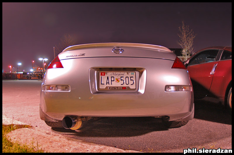

just a couple from the bumper tuck thread. I love the way they look but everybody likes different things.
Attached Thumbnails single exhaust-2427922857_c4ac035ed8_o.jpg   single exhaust-p1030173.jpg

Originally Posted by joe645733
ehh idk. u got a pic of a nicely angled exhaust?
cuz i saw Motormouth's z. and it looks like trash in the rear of the car. (sorry).
whatta nice?
ehh idk dude. i dont think it fits the car too great in my opinion. my friends 240 s14 silvia looks nice cuz its angled to the side and up a little.
i think it would look pretty sick on a z if it was angled up a little. cuz the angled exhausts are just pushed to the side
