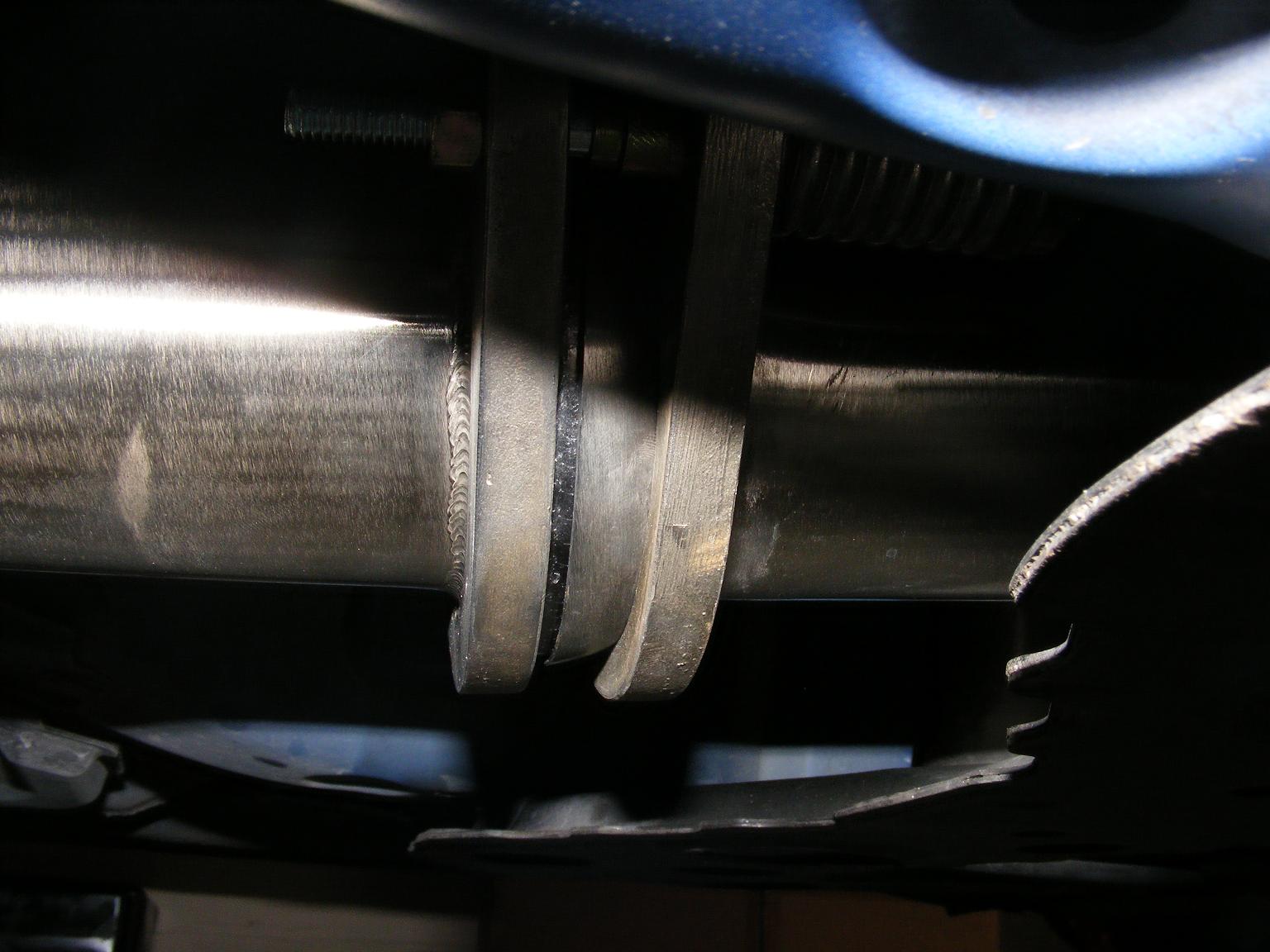

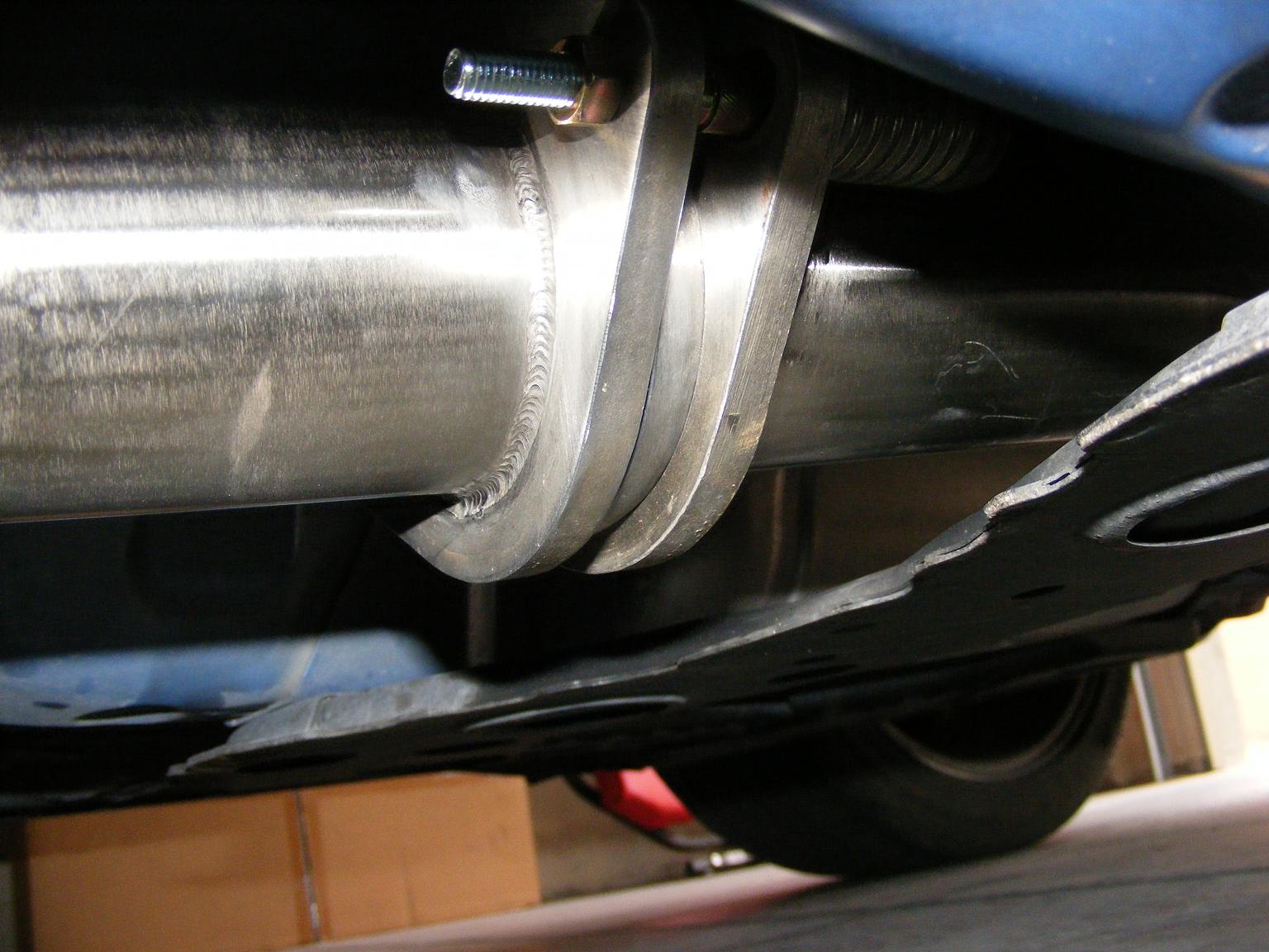

Y to mid-pipe flange. I was mistaken about the clearance to the crossmember on the mid-pipe, I have roughly 3/4 to 1" of clearance there.

Hey Genpac thanks for the pictures man. I have it set up the same way but its still hitting the crossmember. I do not know what to do. It seems that i ran out of thread on the bolt.

I didn't even use the springs on my Turbo XS. I just got a solid bolt and torqued the hell out of it. Gorilla torque specs. Whenever I unbolt this section, for any reason, I bolt it back the same way. I take a socket and place it between the mid brace and the pipe. This ensures clearance and allows me to focus my strength on torquing the bolts down rather than holding the pipe up and torquing the bolts. When you've got it tight, use your wrench or ratchet to tap the socket free.

Hey thanks man, i think thats my only option. Going to to torque the sh.. out of it.

been following thread, same here did not use springs, used longer bolts and torque'ed the **** out of them, no clearance issues, took out silencers, deep throaty sound, but I do have a set of Forged HFC's..... only problem I have is one tip is slightly higher.....

Also had to torque the hell out of the midpipe conection(using solid bolts, no springs) on a couple occasions to stop the sagging and hitting the crossmember. I had a horrible time lining up the Y pipe to the stock cats (1/4" off). I have read that some others had this issue, but not all.

I added small spacers to gain little extra clearance for the M brace. My mid pipe was just about touching the brace after the install. I knew that would definitely be trouble. The spacers under the M brace fixed the issue. After driving with the exhaust for over a week, I am really starting to dig it. Either I got used to it or it seemed to have gotten quiet over the last few days. I am driving with the silencers for now because of the highway drone but if this keeps up, I may take them out and let it rip.
