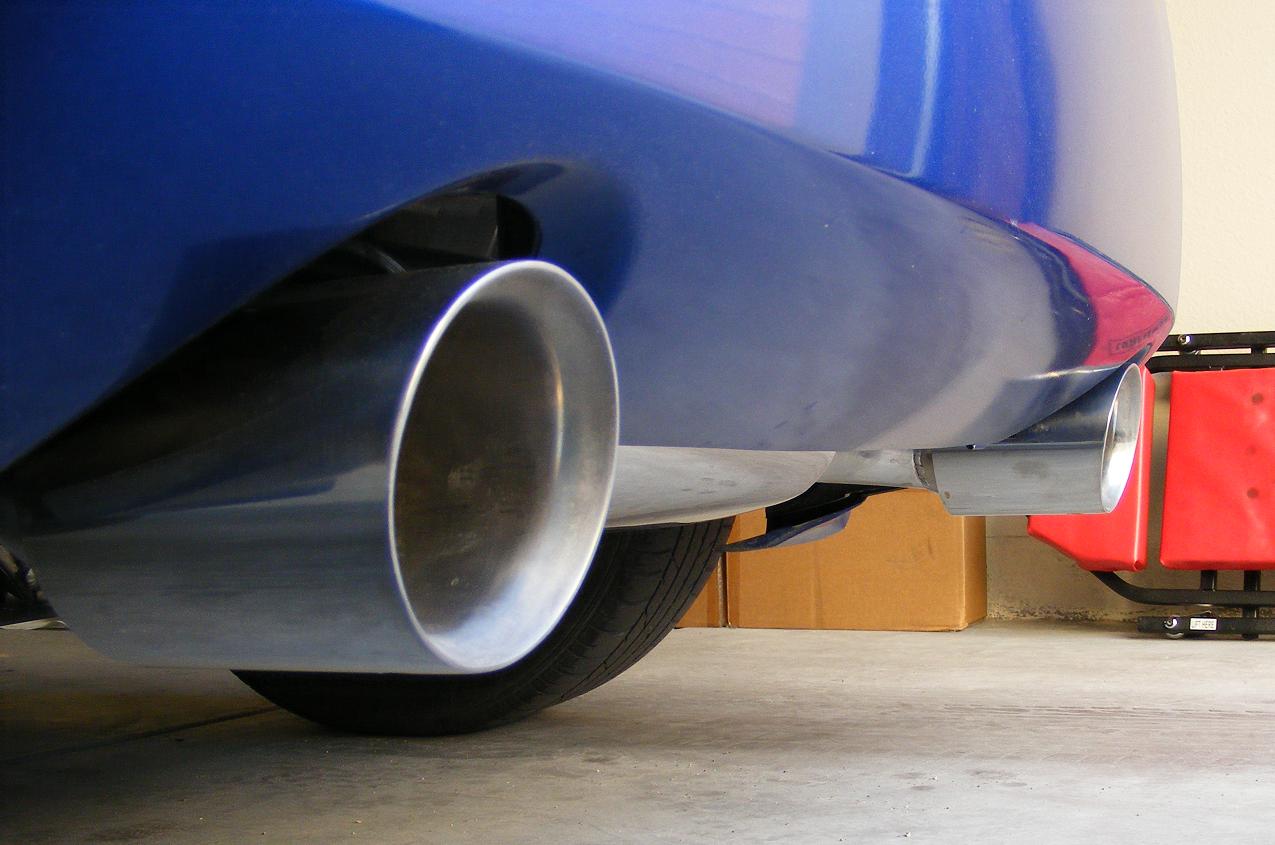

I just finished installing this exhaust on my DD -- 2003 Touring.
Like others have described, the tone of this exhaust is 'similar' to stock but much louder. Grunty and low beneath 1800 rpm and really ramps up the decibels above that.
I am running stock cats, stock intake.
I do have to point out two caveats I came across with this exhaust...

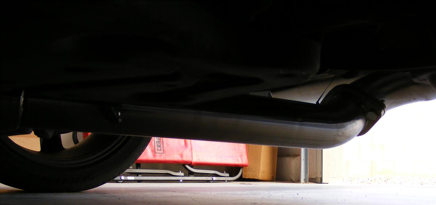

1. Where the mid-pipe meets the muffler assembly now becomes your lowest point on the suspension for the rear half. I have huge speed bumps where I work so your concerns may vary.

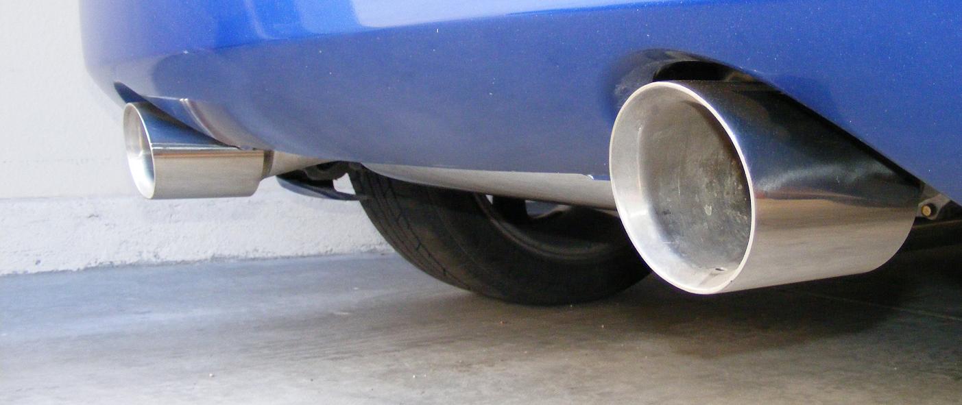

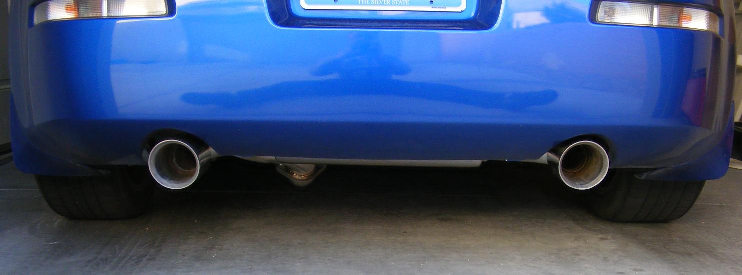

2. I've noticed on other user pictures of this exhaust installed it looked like the drivers side exhaust tip sits lower than the passenger side...
This is also true for my exhaust.
I have pictures of both issues so future buyers can judge for themselves.
Installation was a breeze. (45min) Having doused my stock exhaust with penetrating oil the evening before, the nuts released from their 6 year old positions with ease. I installed the muffler assembly first, Y-pipe second and mid-pipe last. Tightened everything from the front back, then again to make certain.
For the price Z-1 Performance has it, I can't be happier with this mod. If this was a few hundred more, the crooked tips would have driven me insane. I plan on lowering the Passenger side exhaust hanger about 1/4 inch and this should bring the tips inline.
CLIFFS: Easy 45minute install, tips are crooked, rear flange sits low -- still a great value, regardless.

Im sure if you took it to a muffler shop they could maybe bend some hangers and adjust the tips until they are even.

Thanks for the 'tip' I'm going to attempt spacing down the bracket that the rubber hanger is on first... If that effort proves fruitless, I'll go your suggested route.

Hey guys ive been rolling with the turboxs exhaust for the past 2 weeks and i prefer the silencers on only cause i travel 45 minutes to school everyday. I think the sound is awesome without the silencers, there is no drone unless your below 2k rpms. My tips were perfect, but im still having trouble with the midpipe hanging too low and hitting my cross bar. Overall, excellent exhaust for the money.

I had Zero issues with the mid-pipe hitting the crossmember. When I tightened the Mid-pipe to Y-pipe (doughnut), I held the mid-pipe Up, torqued to roughly 75% then torqued the rear flange to Muffler assembly. Got that end about 75% torqued then came back to the center flange, finished torquing center and then the rear. I can take a picture if anyone wants to see but I have over an inch, probably closer to two inches of clearance at the crossmember.
