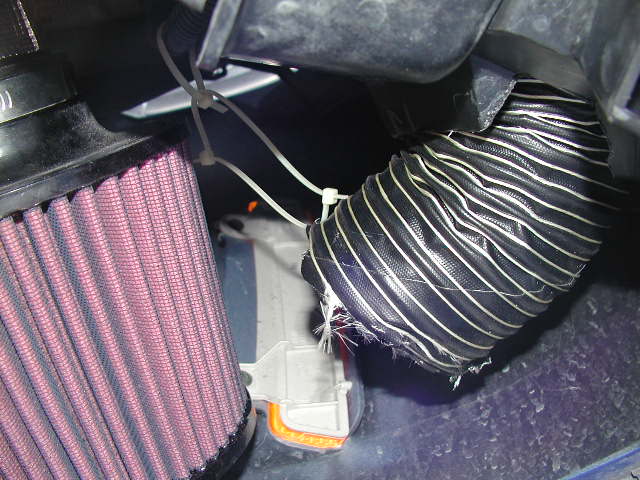

this is a view from under the car of the duct tube as it come through the ridged panel and directs air onto the cone filter of my NISMO intake...
I think if this panel were removed, air would flow freely into the area where the cone filter of a NISMO or AEM filter sits.

this is how the NISMO (and AEM) intake looks with the wheel well liner removed.... you can just barely make out the ridged panel (before I cut the hole) behind the cone filter...
I have wrapped the intake tubing with heat shielding to help keep the air going through from absorbing any heat from the brakes...

Makes me wonder what would happen if you had a duct running from the air inlet to the stock location. With K&N dropin in the stock location, it maybe close to an injen intake, maybe not, lol.

To remove the separator panel between the wheel well and the grill area I used precise instruments: A pair of pliers and a lot or pulling, twisting, crunching, cracking. Eventually I got all the pieces out. :-)
And I still assert, as others have hinted here, that if the separator is removed, the intake in the wheelwell will still benefit from positive air pressure without any "scoops" or whatever, simply from the positive air pressure in the grill.
However, who knows? Who cares? I know it breaths better now, I know it sounds like sweet metalic music, and it looks good.
