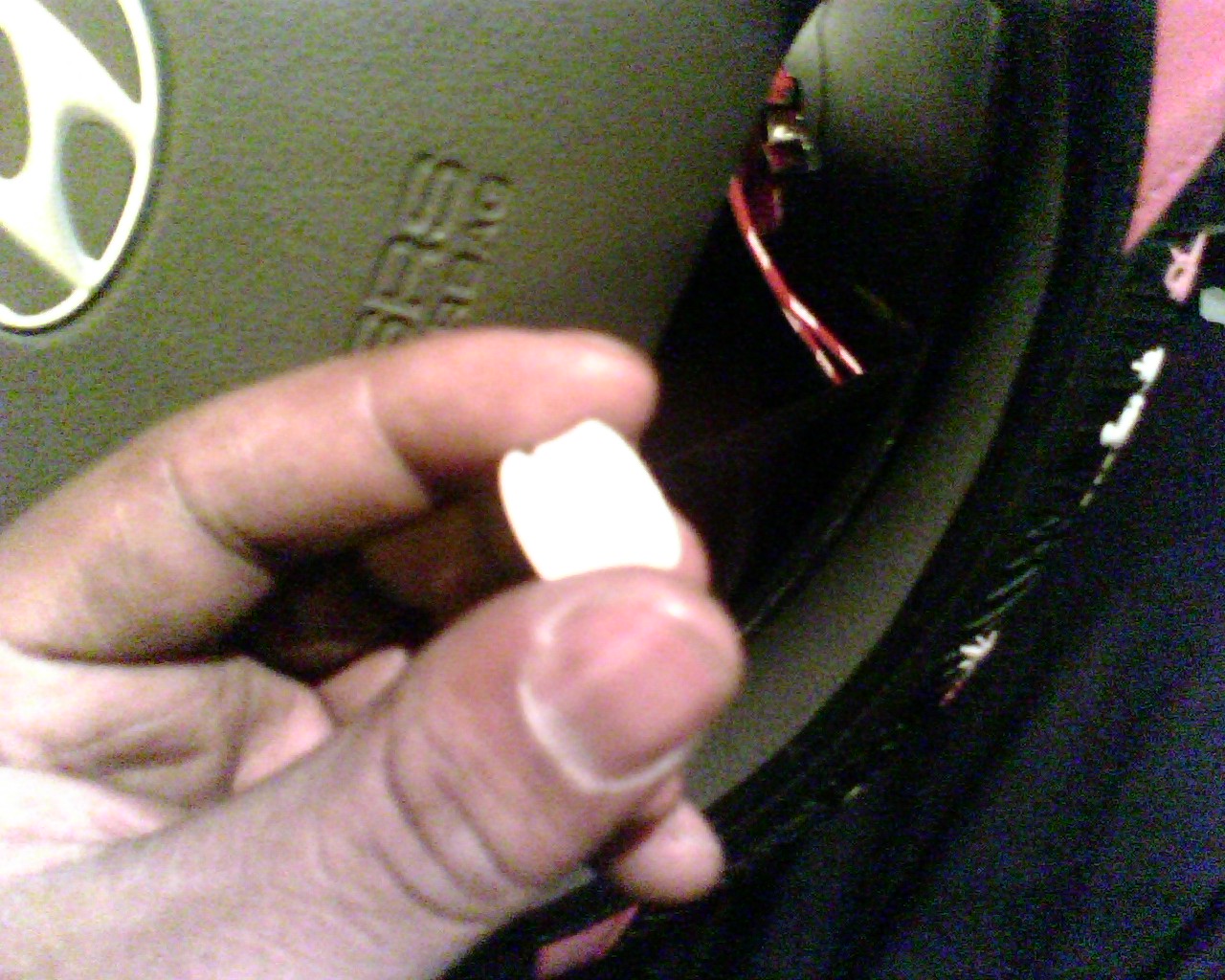

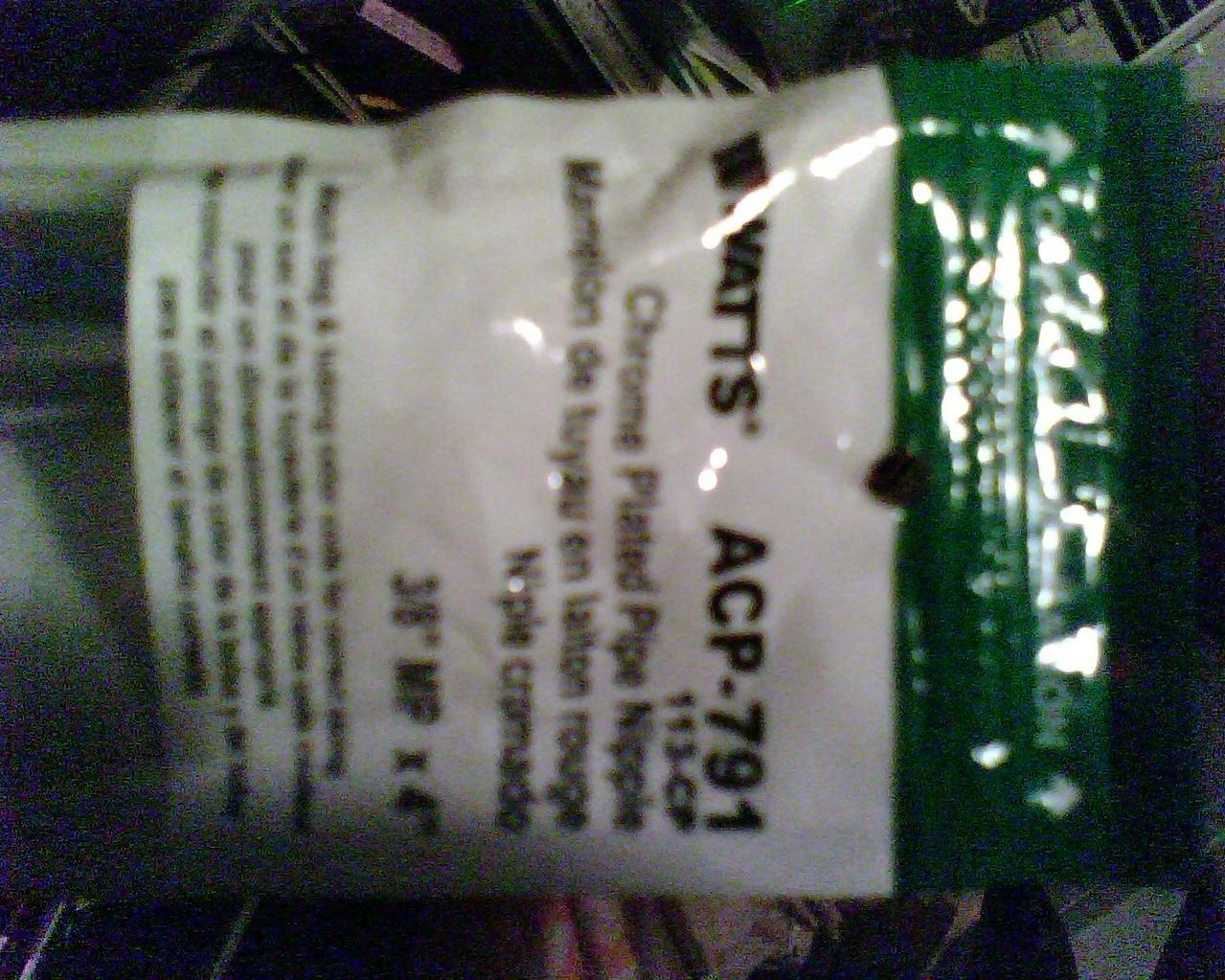

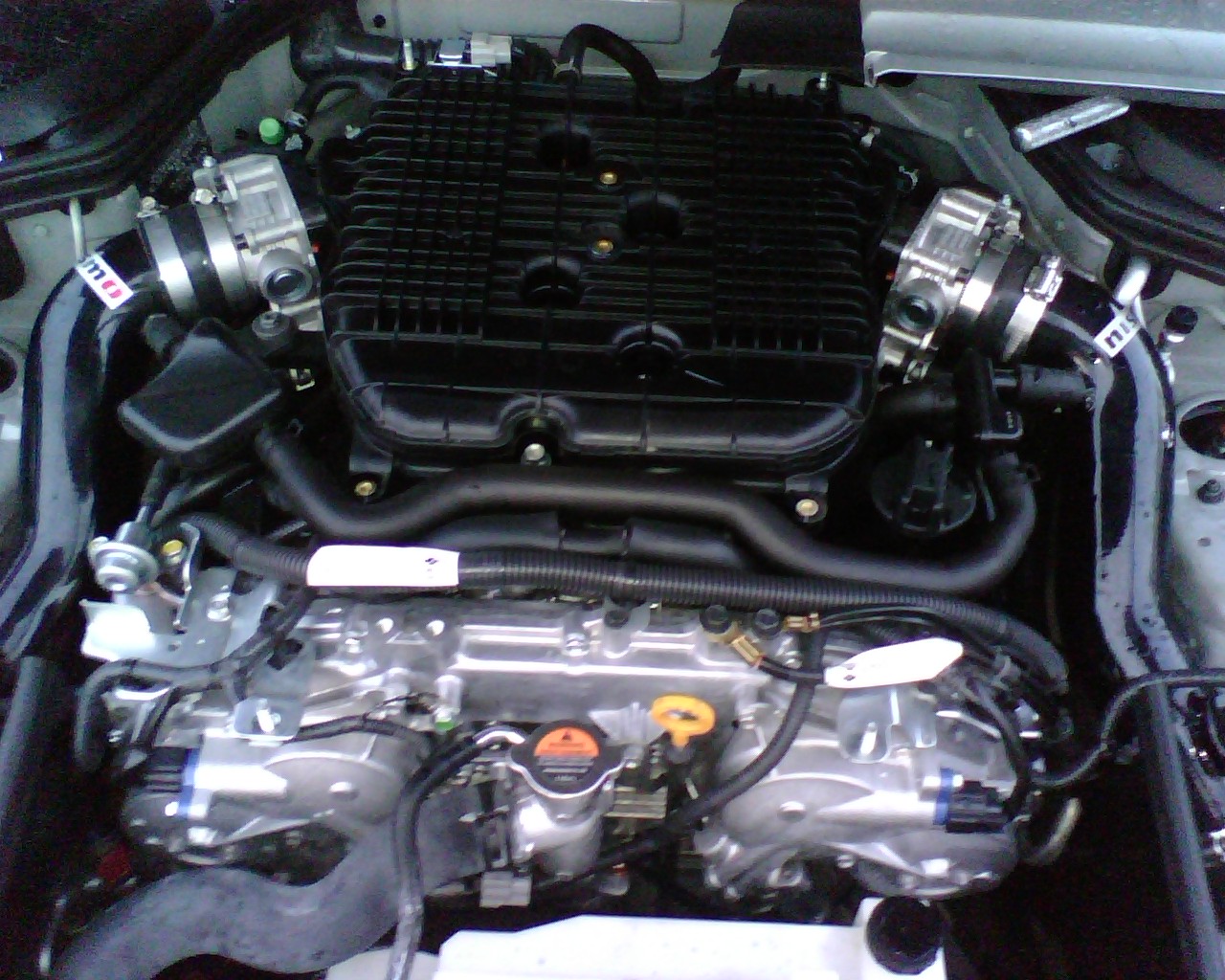

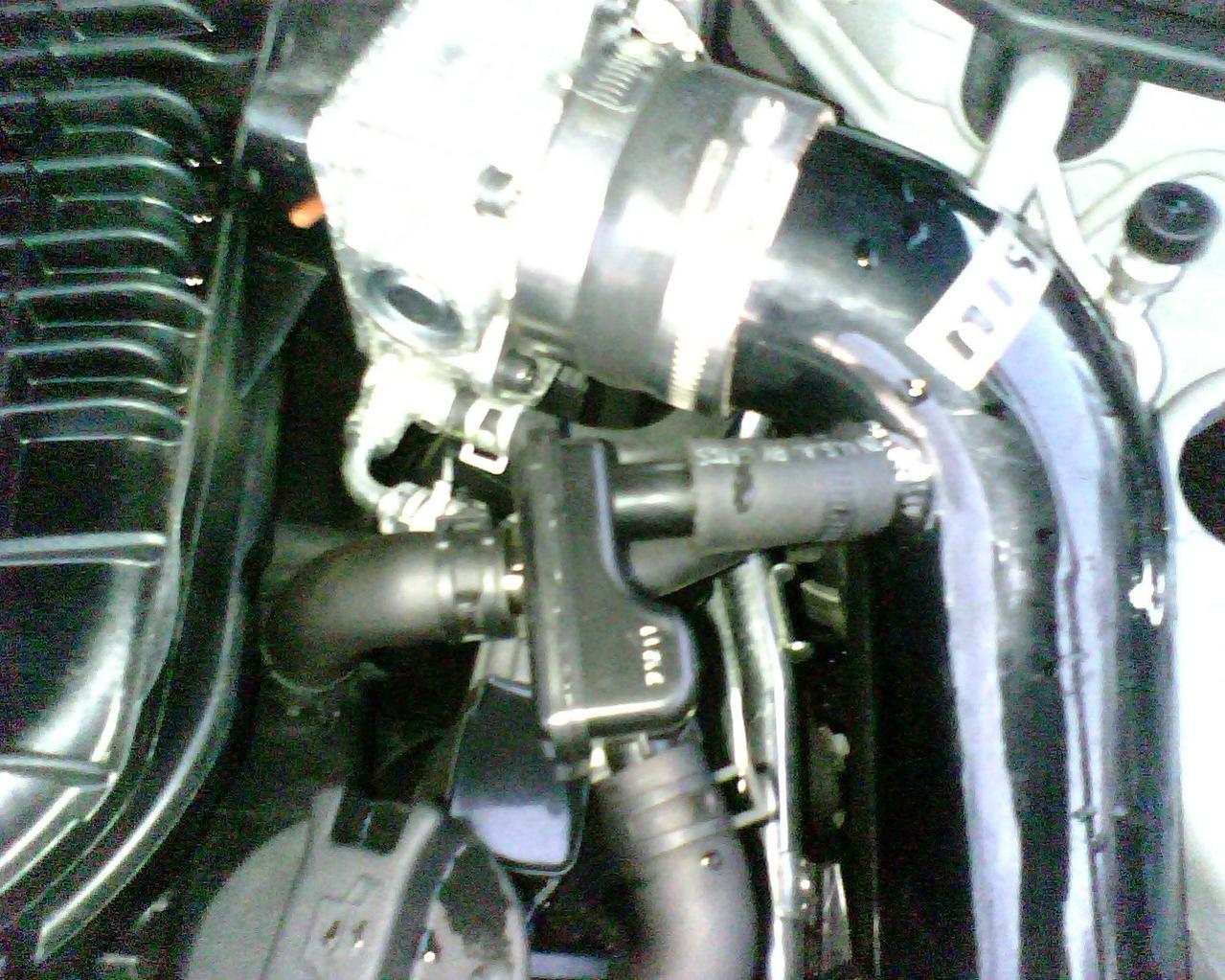

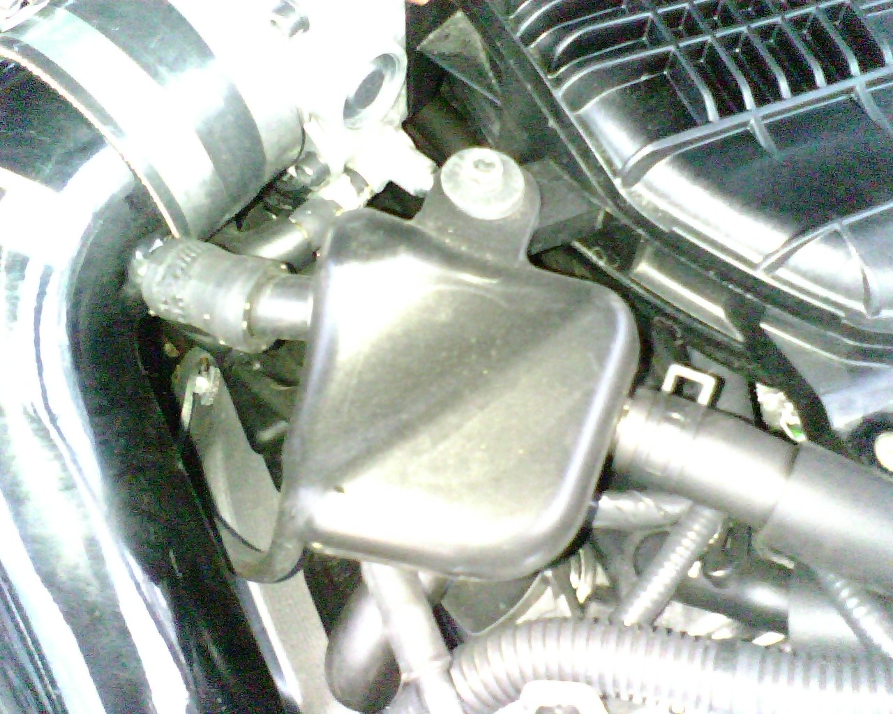

Here are my pics form my Sidekick Last night:
The first pic is with the engine covers and strut bar off. I'm a dumb *** and didnt realize the cover was 2 pieces.
2nd and 3rd pic are the baffles. The parts you are deleting, drivers first passanger 2nd.
The 4th pic is the 4 inch chrome pipe i bought from home depot for like 5 bucks. If you have nismo or similair short intakes get a 3 inch. I'm going to have to cut some off here at work because its putting stress on the breather grommet from the valve cover.
Finally the last pic is a white stopper cap that has reverse barbs to perfectly hold it in the passanger side grommet. Fits like nissan made it. fitty cent.
