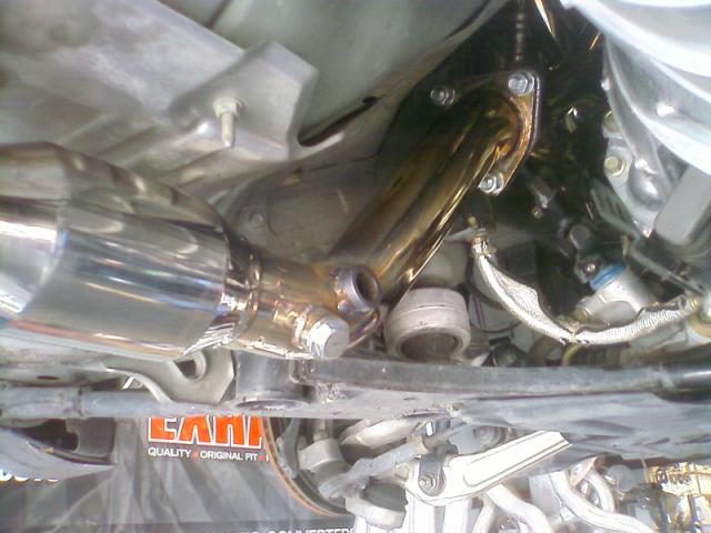

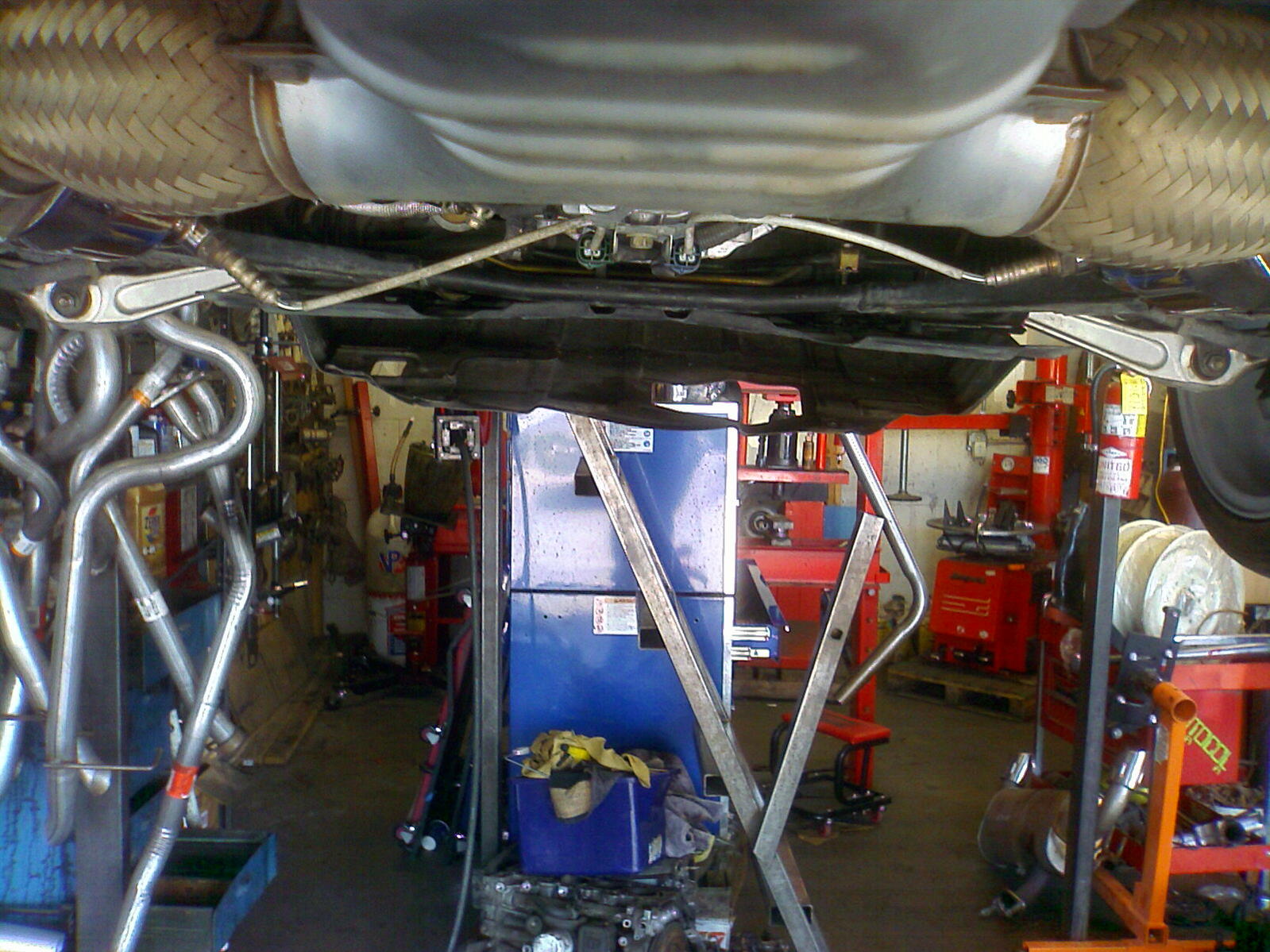

yup I got the same test pipes and had the exact same problem. luckily the shop I go to said they'll modify the 02 bung for $20.

Nice! Did they have to take off the pipe to do the work? I have spare sets of bungs and plugs. Might look into it. Screw it, I'm going to get it done anyway. I'm assuming you kept the stock exhaust after the pipes.

Nope didn't have to take the test pipe off. Got it on the lift and drilled a hole and welded the new bung. Cake.

I have a Custom true dual magnaflow 2.5" exhaust. exhaust system consist of magnaflow tru x muffler after the test pipes then two resonators and then two round magnaflow canisters side by side horizontal.
