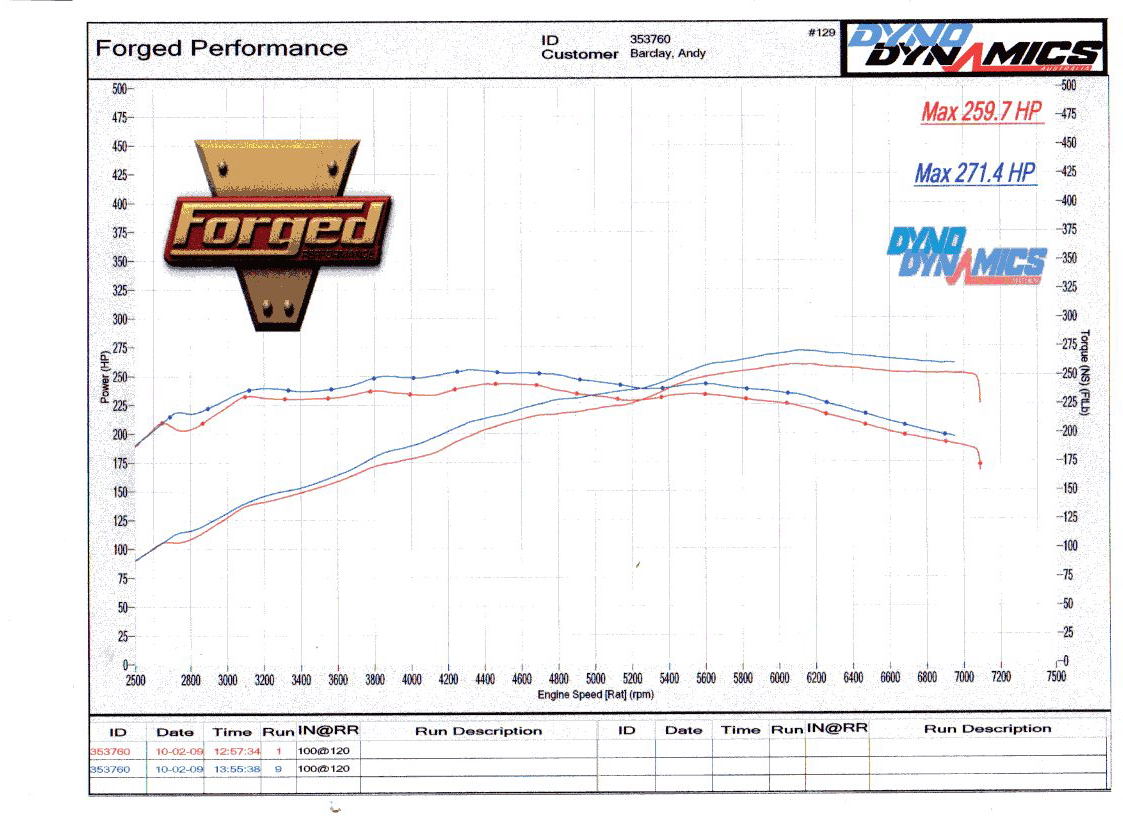

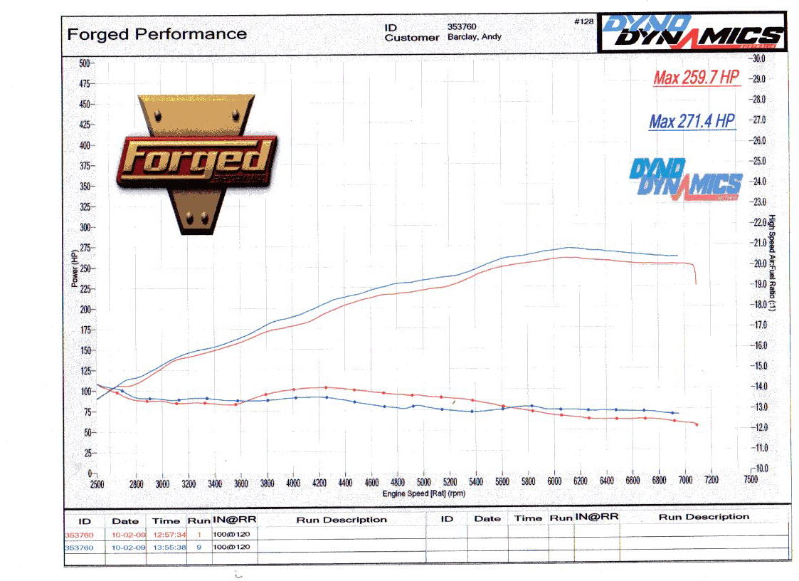

Okay...onto the performance/sound. I wasn't looking for ridiculous gains, just something that can keep me content until I've got the chedder-bling for a TT. I feel safe saying that there is a big power difference in my mid-to-high RPM range. Whereas before the parts where installed, it felt like the power tapered off at the top of the range, now the torque is much more consistent throughout the entire RPM range, and much more present above 4500 RPMs. Sharif said he was really surprised by the results considering I don't have a CAI or headers. The car really just wants to keep pulling up to redline, and maybe now I can hang with a few HR's On a side note, if I can tell this big of a difference with only minimal bolt-on parts, I can only imagine what a TT'd or SC'd Z feels like.

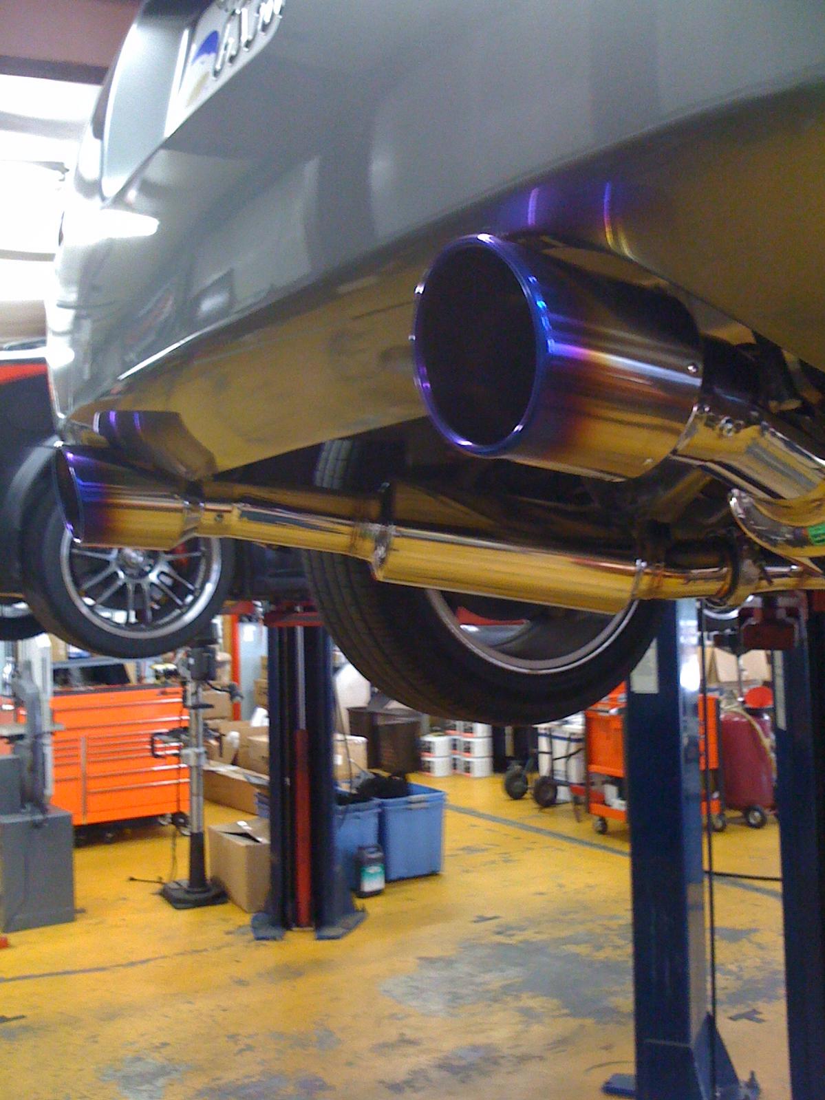

The sound to me is perfect. I DD my Z and didn't want something raspy or "I can hear him coming, he's probably 15 minutes away now" loud; and that's why I went with HFCs instead of TPs. Trust me, my car is a lot louder than stock now, but doesn't sound obnoxious. Sharif even said he was really impressed by the sound. When I'm cruising at 2K, the exhaust is a bit louder than stock; and anywhere above 2500 it really comes alive. The only thing I've noticed is that if I'm in too high of a gear, or lightly accelerating around 2000-2500, the exhaust note has a very loud bass tone to it (would it be safe to say that most aftermarket exhaust with HFCs or TPs exhibit this?). I remember theOtherRob said his Shockwave quieted down a little bit after a few weeks of driving, and I'm guessing mine might do the same, but right now I love the sound. If you're looking for a loud and very strong sounding exhaust, I have no doubt that the Shockwave Duel is for you, but if you're looking for something a little bit more DD friendly with zero rasp, I would highly recommend the Gamma or VQ version.
I hope this review was helpful. Below are my dyno/tune results and a few pics. My first run was done with everything installed. Give me a week and I'll try to post a vid. I also have a few more pics in my photo gallery. Thanks for reading and PM me if you've got any questions.

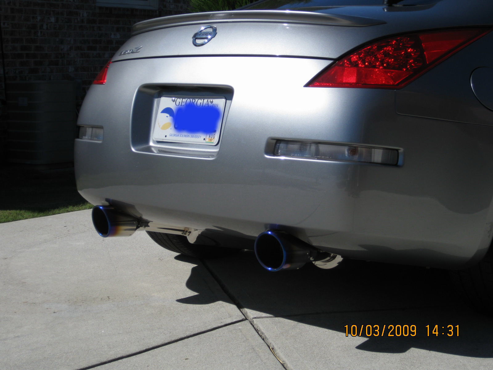

Looks great, congrats! Do you have any pictures from further away to show the size of the tips better?

Sure thing Rob, are you thinking about getting the 4.5 tips? I'd be willing to bet that the Duel Shockwave with straight pipe and non-res TPs would be pretty much punch yo momma in the ovaries loud

Also pls post pics of the exhaust from a normal view/side view/low view about 6-12 ft away.. Thanks
