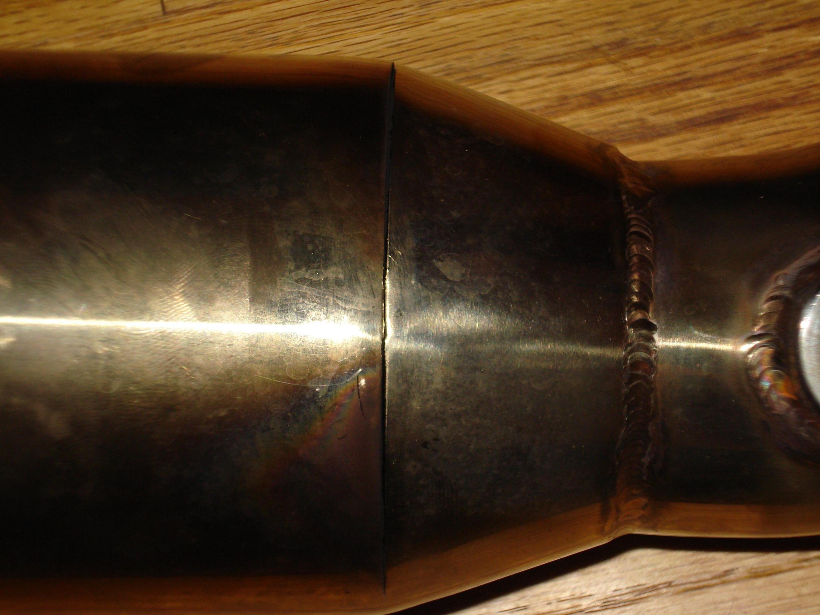

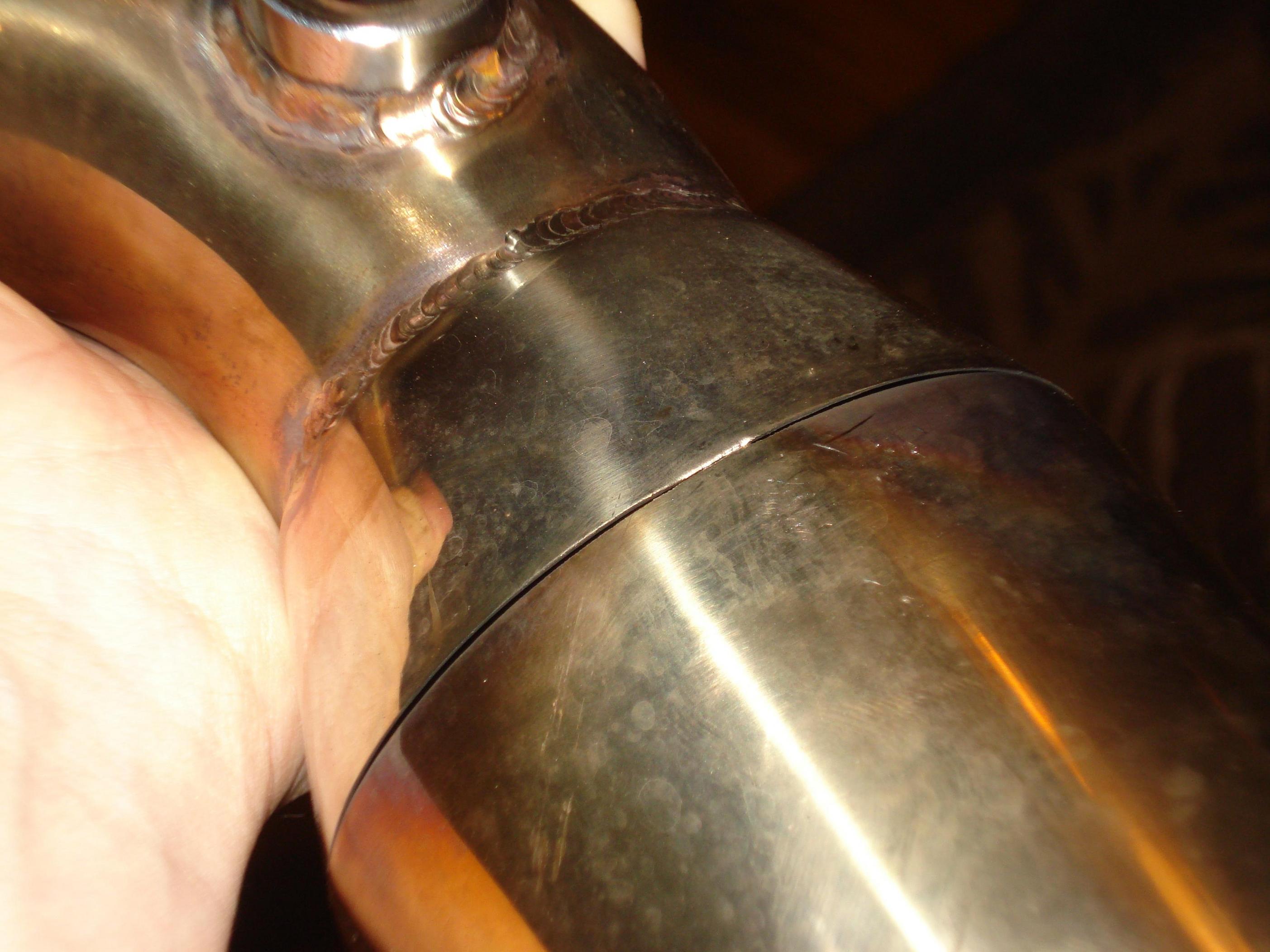

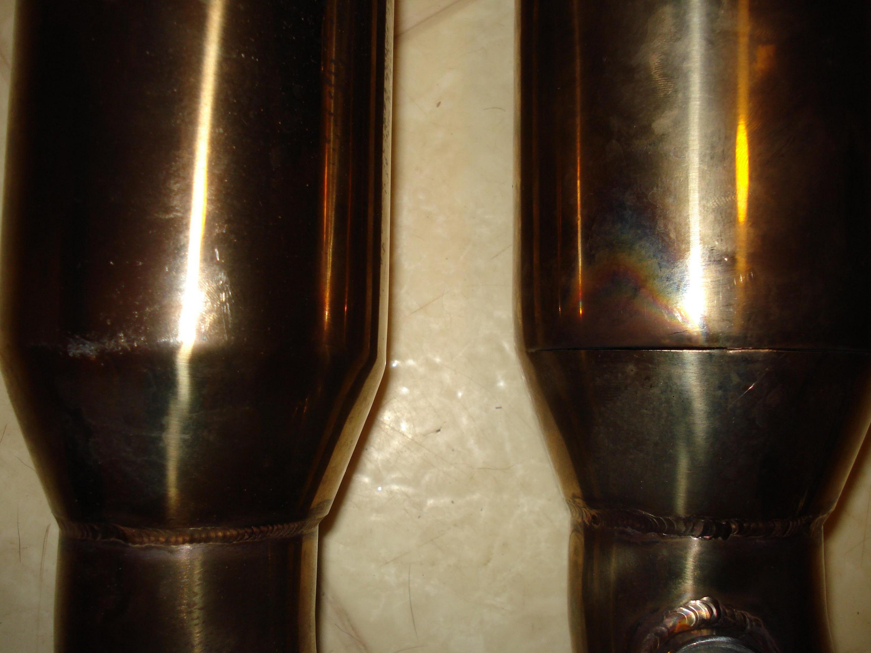

Old Nov 18, 2009 | 06:18 AM
TJGILROY's Avatar
TJGILROY
Joined: Apr 2009
Posts: 932
From: columbia, sc
well i went from Berk's to Invidia because i was having an issue with the fitment with the Berk's HFC's. The left Invidia test pipe cracked...I'll post some pics later...
Old Nov 18, 2009 | 03:54 PM
TJGILROY's Avatar
TJGILROY
Joined: Apr 2009
Posts: 932
From: columbia, sc
i guess this is the chance you take with test pipes....
