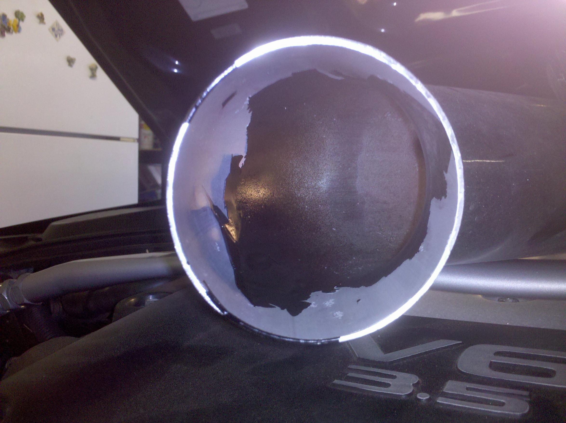

Old May 20, 2010 | 06:48 PM
underk1979's Avatar
underk1979
Posts: 11
From: Harrisburg, PA
Default Here is the pictures and proof that everyone wanted to see..............
The end that was peeling was the end towards the air filter. Seems **** poor to me.

I learn neew things each day, my Nismo CAI is not painted on the inside, it is just the silver color. How do you spose they painted the inside of the CAI to get full paint coverage??? Did the MAF look like it is brand new???
Old May 21, 2010 | 03:41 AM
underk1979's Avatar
underk1979
Posts: 11
The MAF sensor did look new and it is a good question on why the inside of the CAI would be painted. Front what I saw, it doesn't look like the whole thing is painted, it was worse on the end where the air filter went.
I know it won't do me any good, but I want to get this pictures over to Nissan/NISMO so they can see for themselves.

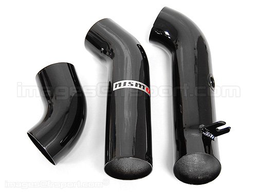

Here is a pic I grabbed off the net. I am going to change out my air filter this weekend and I will shoot a pic of mine for comparison. At least the mechanic sounds honest in this situation. I wonder what NISMO will say about the paint on the inside of the tube? I can really see no reason to paint aluminum, it's not like it is going to rust or corrode.

^ That pic you posted looks like it has overspray around the edges of the tube.
OP....thanks for posting pics. Maybe you have a fake NISMO intake? Did you buy it used?
