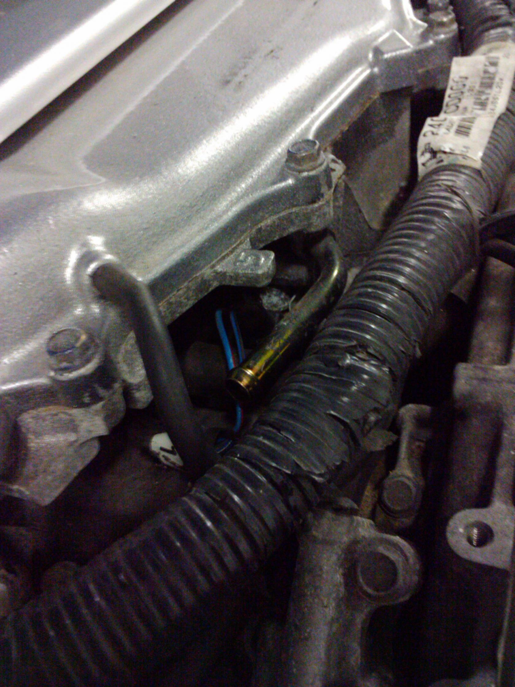

I have a prochrger in my Z. I was doing soe engine work last week and saw this fitting What goes on this? I lugged it for now.

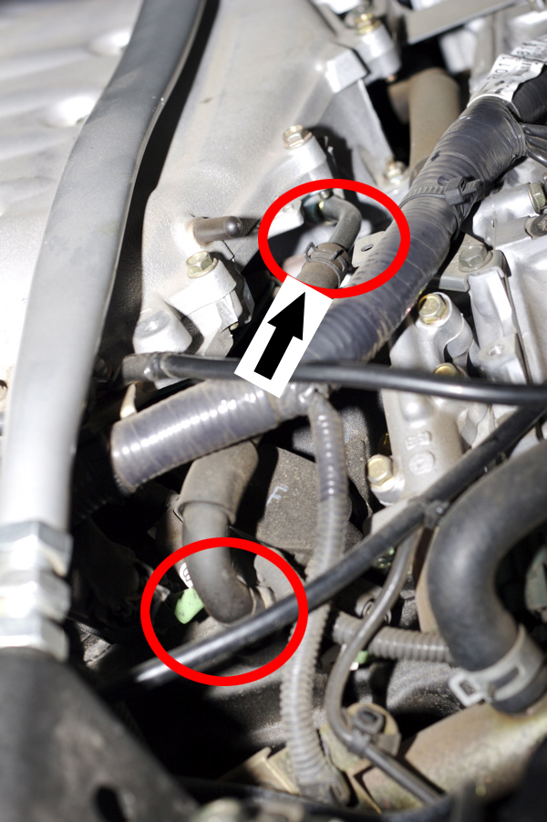

You're missing the PCV hose from your check valve on the valve cover to your intake manifold.

Thank you! my crs running like poop

lol that would be why.
