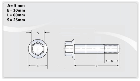

Here you go,
And here's the measurements,
Hope i could help.
