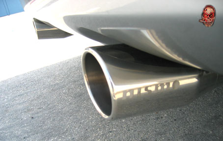

I have the NISMO and highly recommend it.
Changes the whole attitude of the car.
I picked it up from Jason at Performance.
Go for it! you'll be happy.
