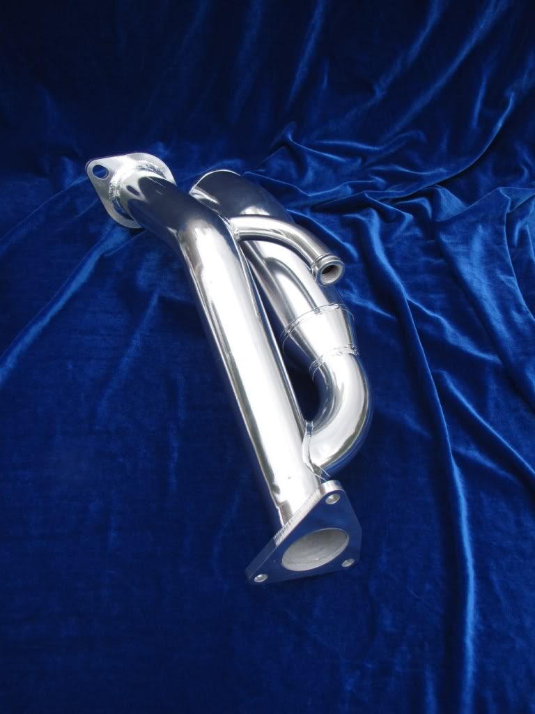

This extension is considerably long and should be sufficient. Some members believe that the longer the extension the better. Or that you should block exhaust gasses with some sort of material such as brillo pad. Wrong. The secondary sensor must read something. It will not operate properly with a zero reading.
I suspect that the test pipe is OK. Look else wear for a solution.

Try taking out the steel wool that's in the bung.
We made a design change to the bung that renders the steel wool overkill. Its not needed any more.
