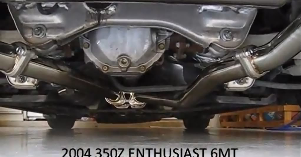

On the left side, yes, but when there is a true dual configuration, the right pipe can either go under the rear sway bar or through a space above it. I personally would like one where it tucks up above. It's just for peace of mind. Here are a few pics:
Q300 (under):
HKS (over):

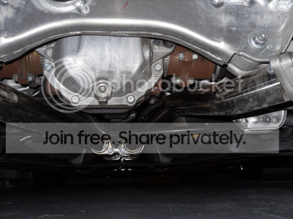

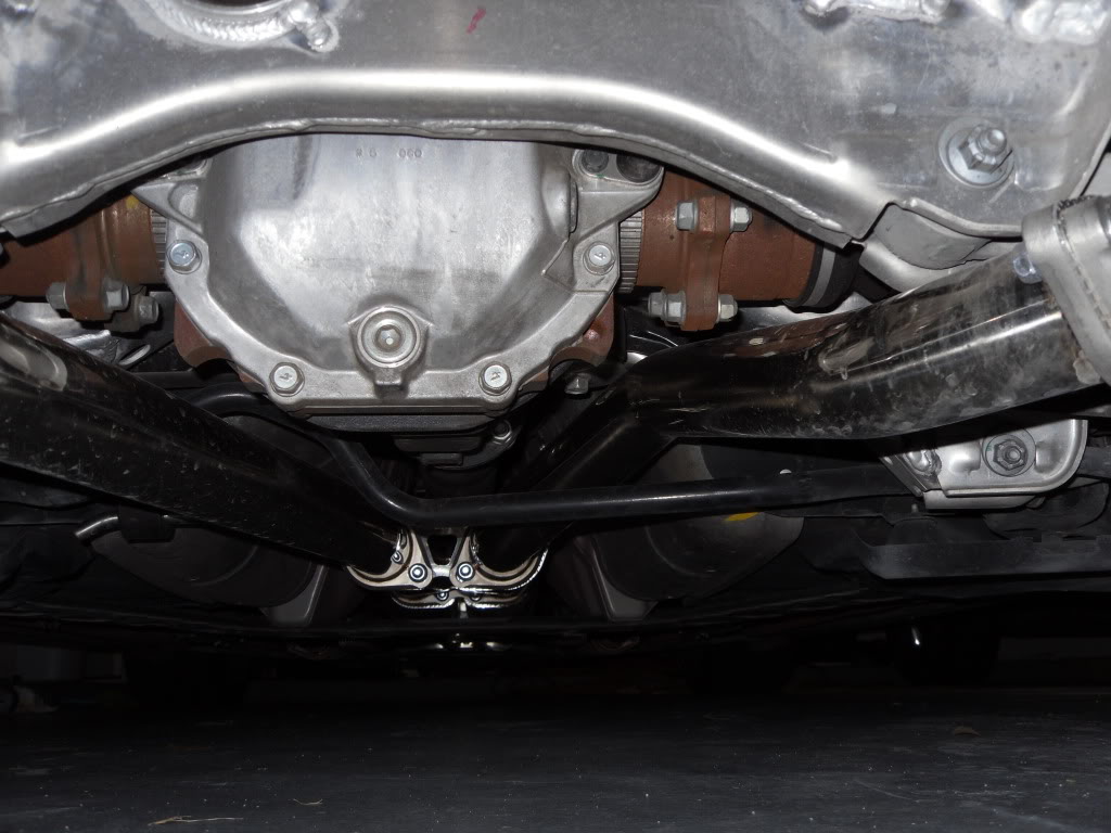

So then did I install that right piece wrong? it fits fine and I haven't had any clearance issues...

From those pics, I'd say it is supposed to sit above the say bar. Here is another shot of a member that just installed his Invidia Gemini:
Old Mar 27, 2012 | 11:22 AM
F2CMaDMaXX's Avatar
F2CMaDMaXX
Joined: Sep 2011
Posts: 1,751
From: Oregon from England
Looks that way, but based on the location/orientation of the bend and the flanges, it'll never rotate to do so based on the previous post picture.
Edit* Actually, looking at it, it appears it might rotate a complete 180 degrees and do just that.

This thread is a tad old now but I forgot to mention that I had emailed Invidia and they confirmed that it indeed goes over the sway bar. For anyone else who might be wondering.
In fact, looking at the pic posted of the Q300 - it appears that pipe is installed wrong as well.
