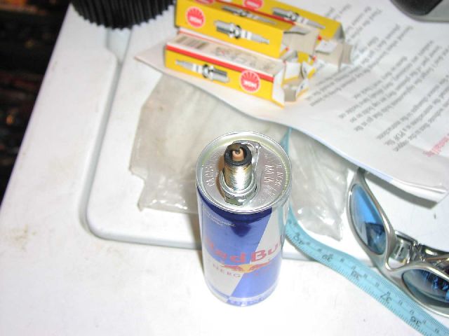

Was a fun but short ride eh EJ? And it was an A5T in D not manual mode and it was WOT w/o any tranny sticking or "lazy shifts.
And my plugs were slightly rich not lean so much for the all people running RT Cat's are lean myth. EGT was at 500-600
Nice to have a witness for a change, come by any time EJ, like uh tomorow hehe! Here is the plug EJ pulled after 7k on new setup and 2k on RT Cats.
Cylinder #6 stock plug before adding the coppers, the car pulls like a scalded dog and purrs like a kitten now and I we routed the belt the better way again ; under the tensioner and it is very quiet.
Zed if you are out there my idle is perfect at .37, 1 heat range colder NGK Coppers! ATI says 35 others are doing 39, I wanted to be different and went right in the middle. I may just head up to TS this Tuesday! Edit all my typos of excitement.
