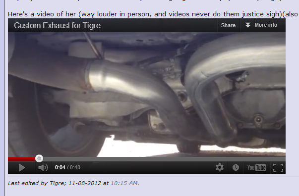

To everyone else. The only reason I am posting right now is to inform others that I have indeed gain power and torque, my tires now squeal in second off the line which they previously did not. Other sites have claimed 10rwhp from the mod. At the begging the car will be slower....but after the ecu adjusts you will tell the difference.
I really don't understand how some of you can't comprehend how the muffler is nothing but completely restrictive. All it does is take your exhaust flow and completely **** it up by doing the exact opposite of what it's supposed to and bouncing the pulses onto one another.
I'll use the garden hose analogy just the same. If you improve the flow of the garden hose up to the head, it will hardly matter since the head will restrict it just the same as before. No matter what flow you have before your exhaust, it will still be greatly reduced by the muffler. Having mufflers on aftermarket exhausts is senseless except to reduce the noise. So I have similar gains to people that spend 600-1500 dollars and much better sound (because of their muffler!). If the aftermarket exhausts had no mufflers they would make likely double the gains.
If you are contemplating doing this mod....DO IT!!! It's a win in every category and I could not be happier!! Power/torque, engine efficieny, and amazing sound. The only downside is if you cruise at 90-95 mph like I do on the highway, you'll have to sound deaden your interior a bit! Oh and I only spend 190 bucks for a superb job.
Anyways I don't really want to waste my time arguing it's basic physics so you guys can choose to believe what you will. Doesn't change how much love I have for my Z and how awesome she is becoming
Here's a video of her (way louder in person, and videos never do them justice sigh)(also this is right after the install, so she was slower till the ecu adjusted):
<iframe width="560" height="315" src="http://www.youtube.com/embed/R7VggS9PlmY" frameborder="0" allowfullscreen></iframe>

^ I have seen you around driving in Orlando. Car does indeed sound nice.

I like the crush bends.
No, in the video with the blue Z and no muffler.

Oh, i beg your pardon, wow, yeah good point!
