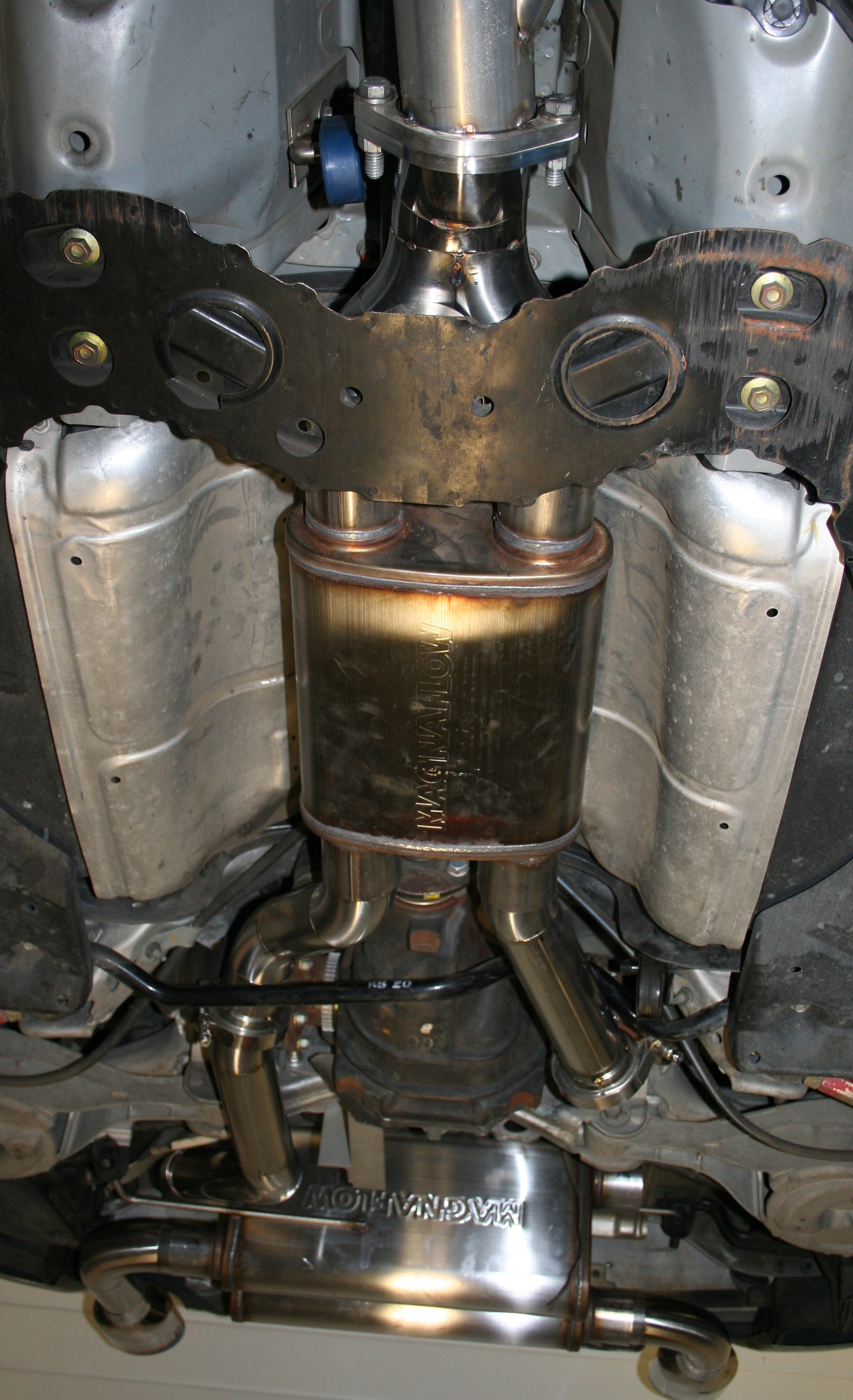

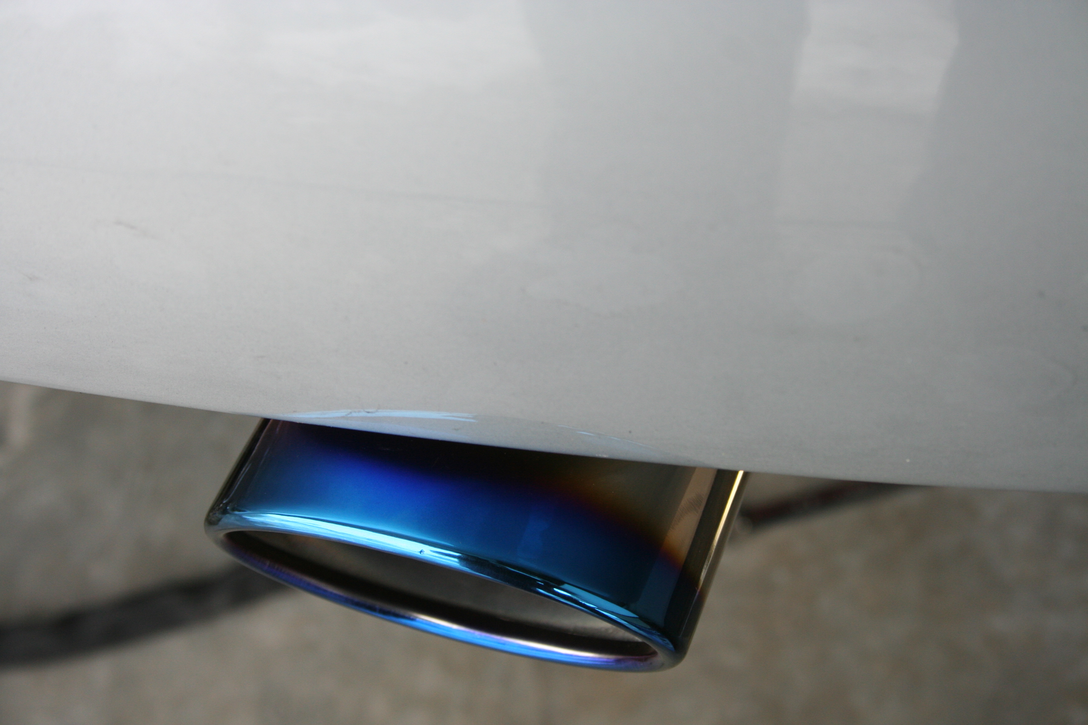

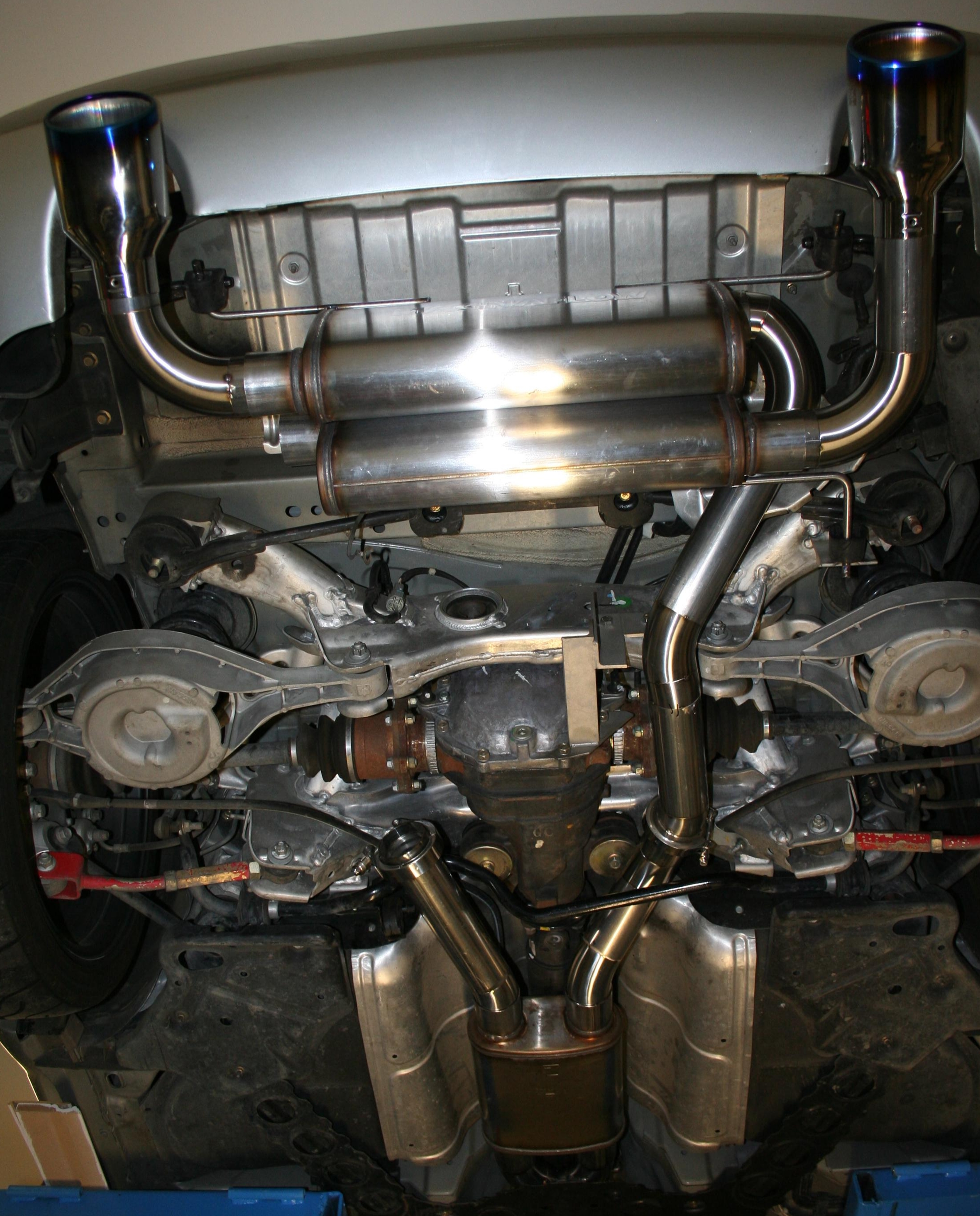

Just finished an exhaust build on my own 350z...thought I share. Dual 2.5" from the OEM Y-pipe:

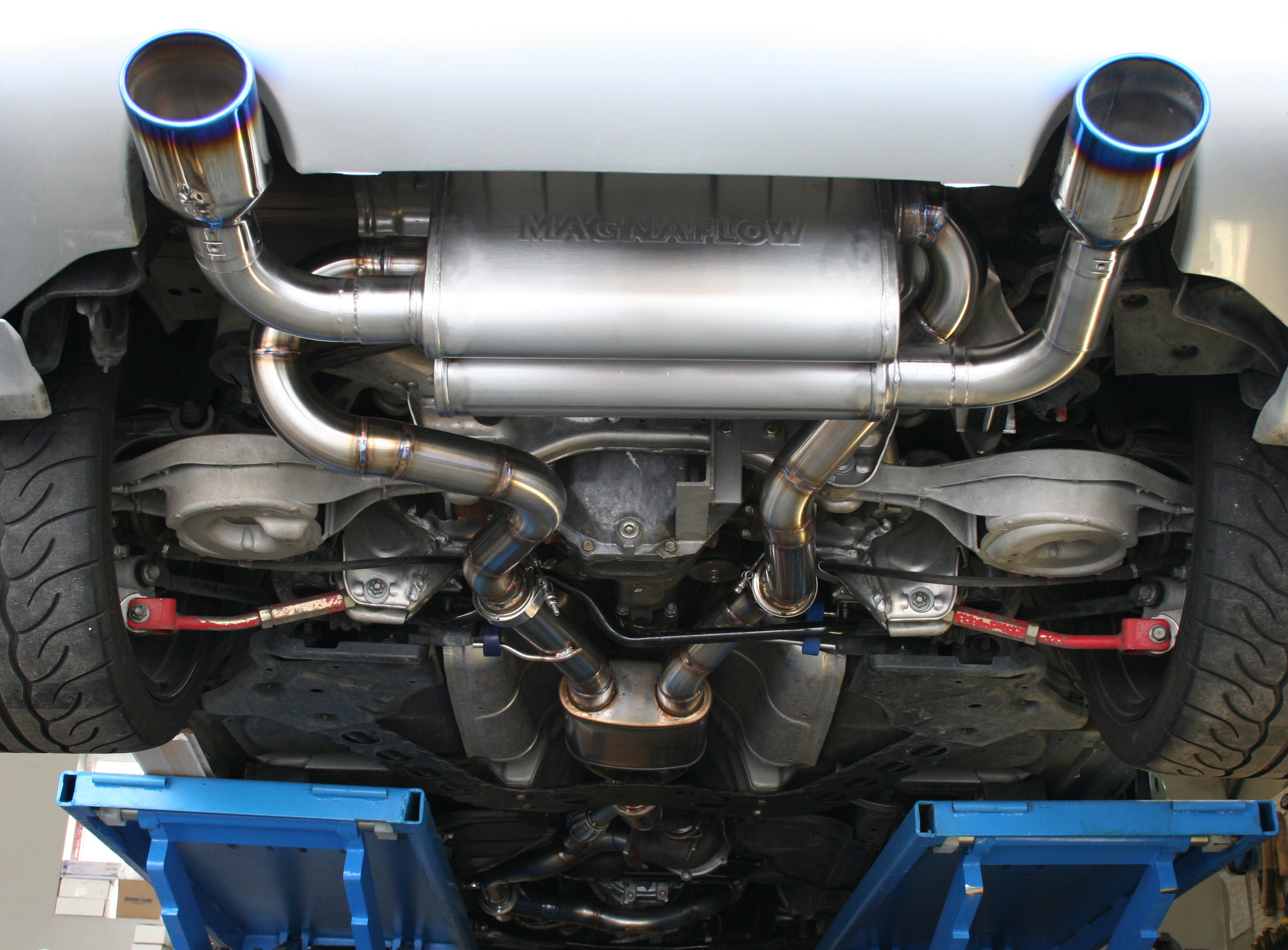

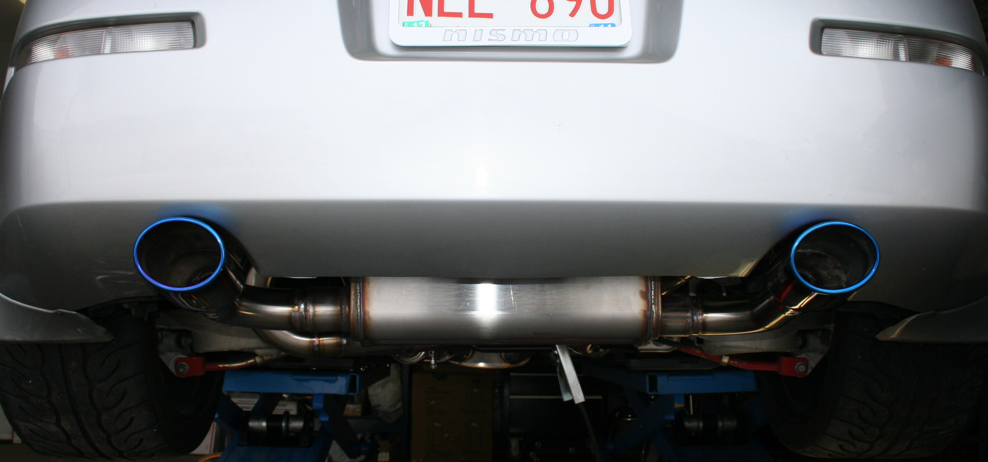

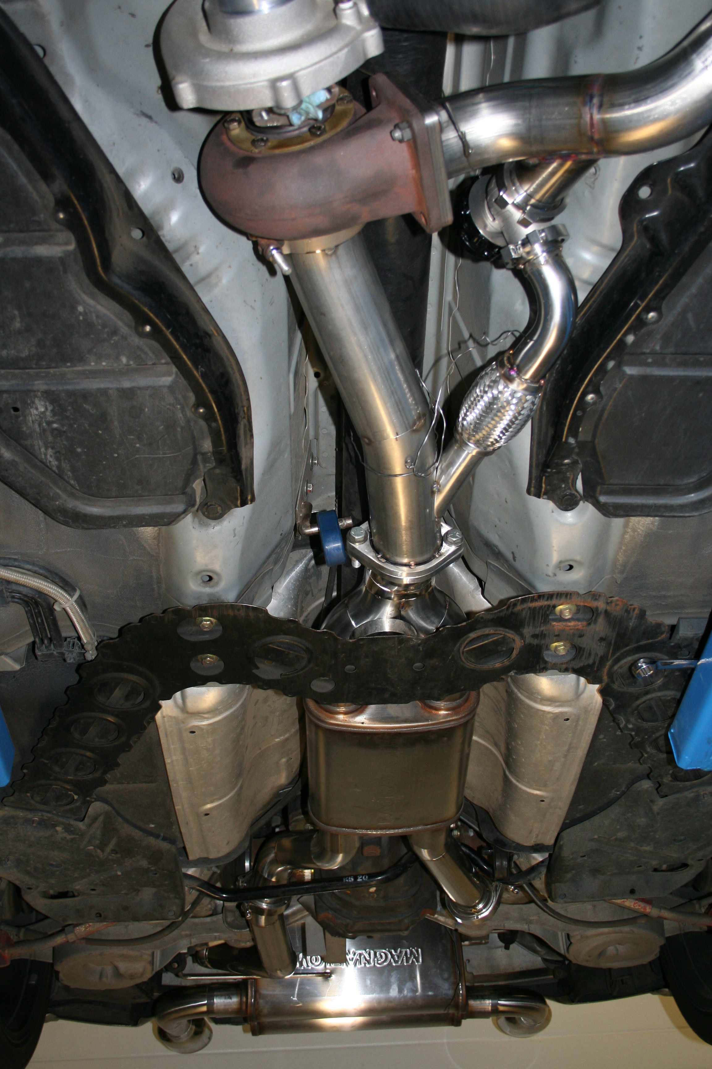

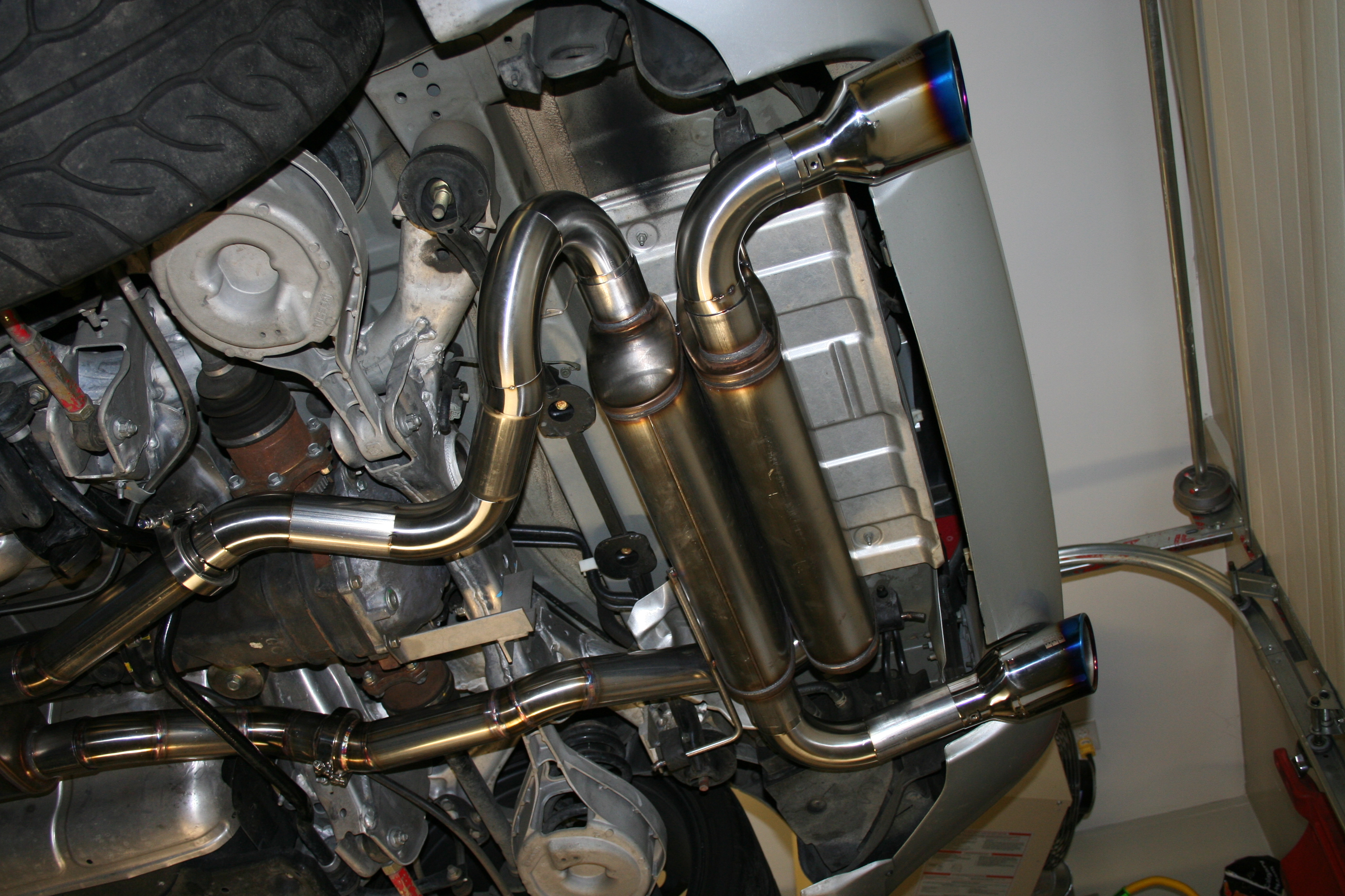

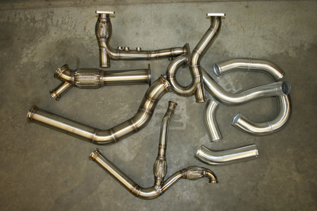

It would not be a good exhaust if it didn't bolt up to the Boosted Performance mid mount turbo kit:
I have not fired the car up since the install, but hope to do it next weekend. Driving videos will be posted once the snow melts...about a month. It should be nice and quiet, yet flow plenty to support a lot of power. All the mufflers are straight flow through design. There won't be any drone (old single with fewer/smaller mufflers didn't drone).

every thought of running the dual in dual out and then just tips instead of another muffler at end? I put a magnaflow on my injen and it is pretty quiet even with hfc...that looks really nice though

Yeah I did...but thought it may still be too loud for an old guy like me...and there is nothing like the sound of the turbo with a nice quiet exhaust that flows well. It is just awesome.

And I dooooooo have it on my car. I was doing some QC on the new batch of mid-mount kits, that is why you see it on the car. Just wanted to make sure everything fits 100% and that my jigs are still perfect.
