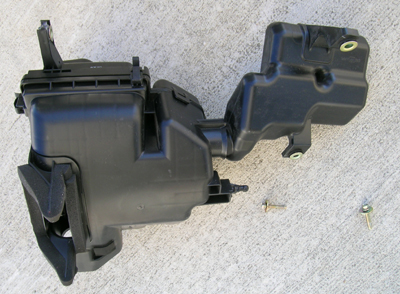

After I removed the stock air box I notice what seemed to be a water/condensation collector that attached to the bottom of the stock air box, that had to go... It doesn't serve a purpose with the new mod, and it probably is blocking some cool air.

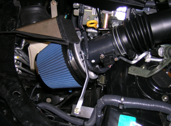

The next thing I noticed is that there's another bracket that firmly secures the PoP Chagers new box in place, here's a pic..

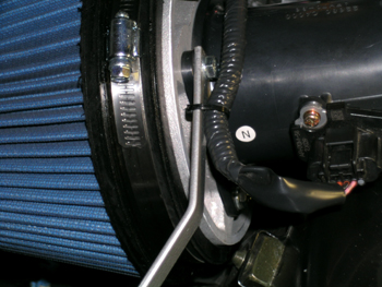

Lastly, there was a lot of slack on the MAF wire, so a finished it off with a wire tie...

Pic 2 - Here's how that bottom piece attached to the stock AirBox.

Pic 3 - The second bracket that comes with the PoP Charger, this is where most of the support comes from.

Pic - 4 I secured the slack in the MAF wire with a wire tie...

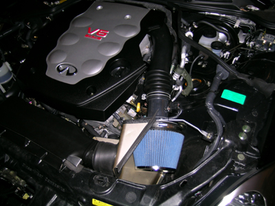

PIC - 5, Completed pic, there does seem to be a bit more potential for the flow of cool air with the bottom portion of the air box removed...

Last Pic - All Done...
