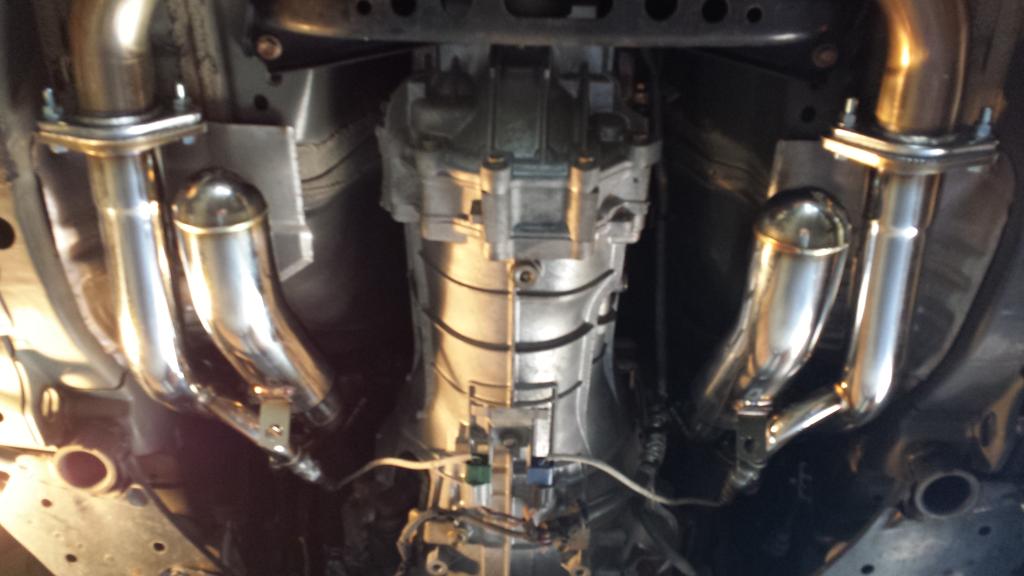

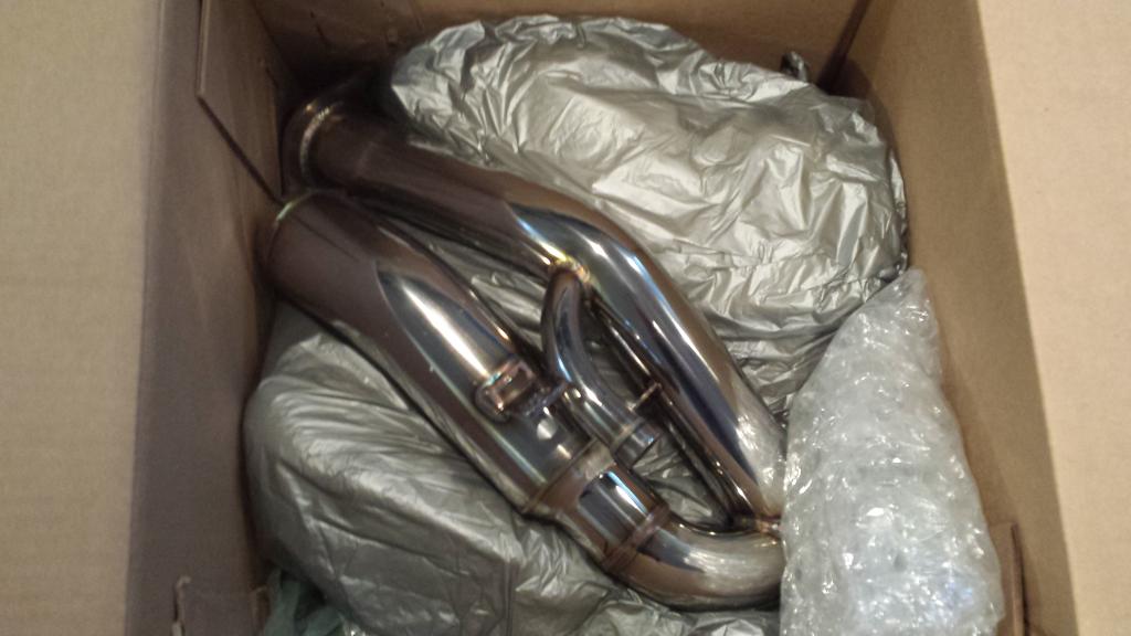

The ART pipes are finally here!

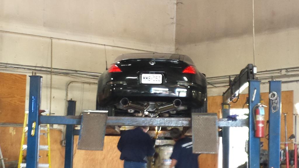

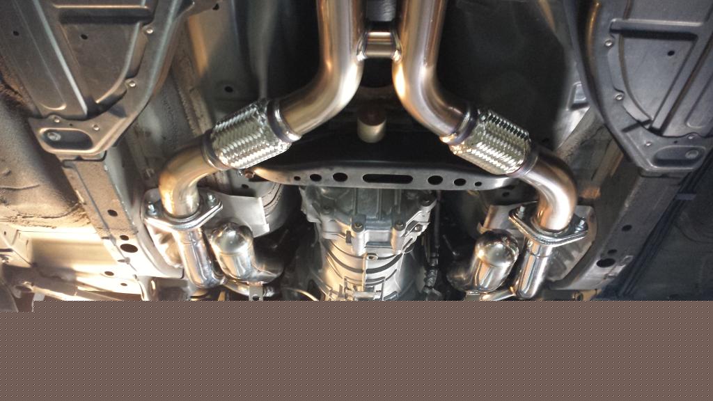

Here they are being installed.

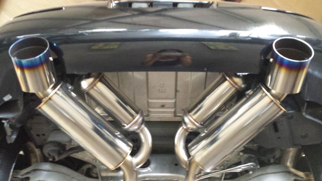

And of course her big fat cans
The HKS pipes now have a much deeper growl, and all rasp and drone are gone. , The horsepower gains in the mid range are def noticeable! Probably one of my favorite mods so far. Well worth the money! Will post an exhaust clip soon.

What are those brackets on the canisters for?
I would love to get ART Pipes to pair up with my Nismo but I do not want to risk cracking them since I still have my S-Tune y pipe and the ART Pipes don't have flex joints OR brackets.
cat brace.... which obviously she doesn't have, and i would highly recommend getting it. it helps keep the art pipe from twisting side to side thus helping limit the possibility of cracking. later on when you get tuned, remove the anti foulers, because they can adjust that afr to where you don't need them, or even turn off the sensors (but they still read available to the ecu)
