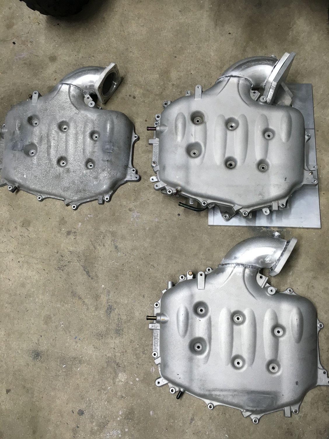

This outflows a kinetix velocity and fits like stock.
