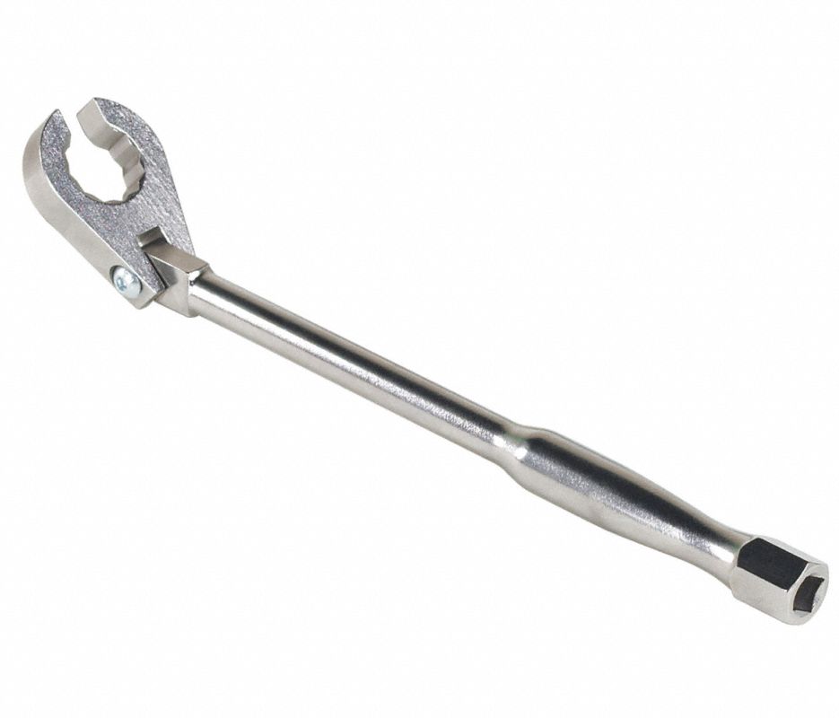

they make sockets and wrenches for sensors... but how often would you use it if you bought one>
