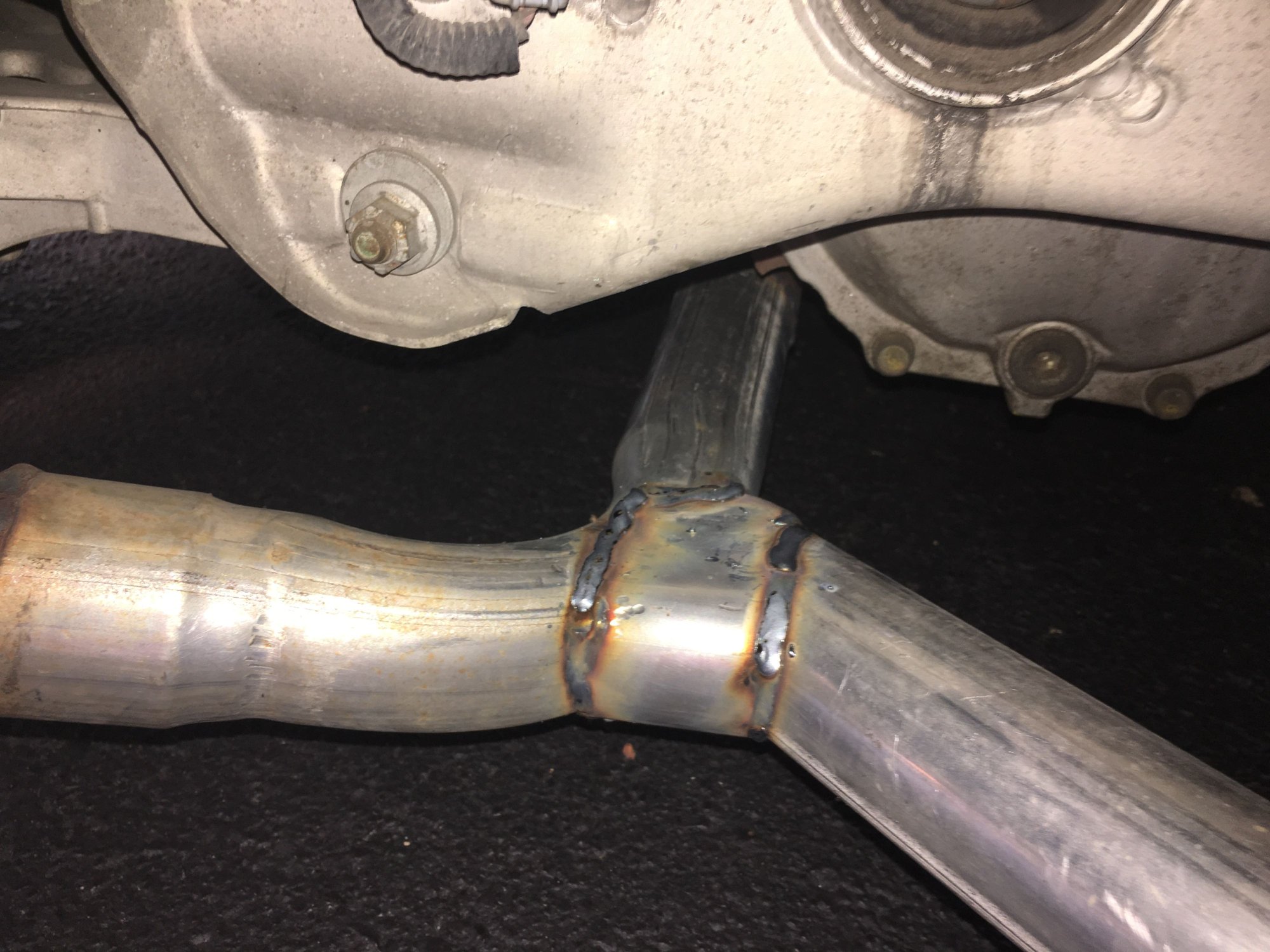

Fixed! The shop had just welded a pipe into the elbow of a 45 which left a sharp edge that made it whistle, so they cut it out and welded this in to smooth out the airflow.

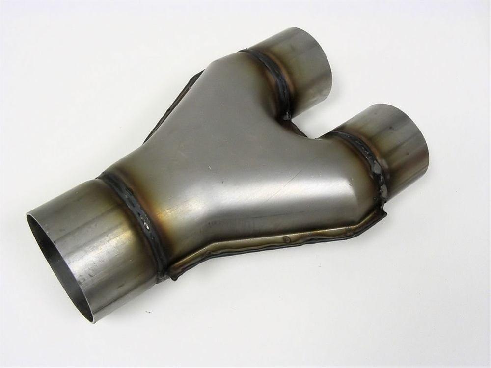

oh that looks like ***.... they should have used something like this. but if you are happy, that is all that matters

lol that "fix" probably makes it more restrictive than stock, just louder.. no smooth bends, i bet there are still sharp edges inside.. and the crush bends.. If an exhaust shop did that to my car id be more than pissed.

To each there own with the muffler delete l, but honestly those welds and that connection looks horrible. I hope u didn't pay more than 25-50 bucks to have this done. I wouldn't pay a dime for that honestly

They charged me $80, yeah it was an exhaust shop that did it but they were dismissive about all of my requests. It's hideous and I'm sure it's not ideal, but my car is mostly stock and I'm happy with the sound, so I could honestly care less. This is not a permanent setup, I can't afford a full exhaust setup on my broke *** college student budget and this gave me exactly the sound I wanted, so whatevs.

So instead of saving that 80 bucks towards exhaust..... you wasted it on a hack job.
i think stevie wonder could have done a better job welding

A real y-pipe probably would have doubled the price since the shop would mark it up a lot.

I see nothing wrong with what he paid for. He paid $80 and got an $80 job. It isn't going to negatively affect performance AT ALL. The cats are still the most restrictive part of the exhaust.

Yes, the shop owner said using a y-pipe would make things more difficult (I HIGHLY doubt it especially after they had to hack that together) and more expensive. I knew I was getting what I paid for, and I was okay with that because I love how my car sounds now. It's my daily and I just wanted the signature VQ sound just a little louder than stock. If I start dumping money into the car obviously I'm going to put in an actual exhaust system, but that's going to be at least two years from now, so this will hold me over. Thanks for being the only one not flaming me @iideadeyeii
