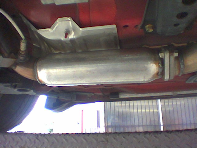

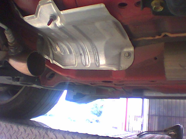

I had the same rasp problem on my car when I installed race pipes. I saw kinetix made race pipes with inline resonators. Thing is, I had already spent almost 200 on my regular race pipes, did not want to drop 400 on some with resonators. So I did the next best thing. I went to a specialized muffler shop that makes custom exhausts for cars and had them weld resonators to the race pipes right past the O2 sensors. It took just over an hour, $95 for both resonators and installation.
Here is a picture of how it used to look
Old Jun 22, 2004 | 04:38 PM
  #173
chaparro78's Avatar
chaparro78
Posts: 709
From: Keller, TX
A piece of the race pipe as well as a piece of my exhaust were cut in order to make room for the resonator
Attached Thumbnails Raspy, buzzing exhaust @2500-3000 rpm-racepipeexhaust.jpg
Old Jun 22, 2004 | 04:39 PM
  #174
chaparro78's Avatar
chaparro78
Posts: 709
From: Keller, TX
Then the flange is welded to one side of the resonator and the race pipe to the other
Old Jun 22, 2004 | 04:41 PM
  #175
chaparro78's Avatar
chaparro78
Posts: 709
From: Keller, TX
Finished product
=No more rasp
=No loss of airflow
=Deep tone
The resonators are 12 inches - 2 3/4" on the inside, just over 4" on the outside
Attached Thumbnails Raspy, buzzing exhaust @2500-3000 rpm-dualresonators.jpg
