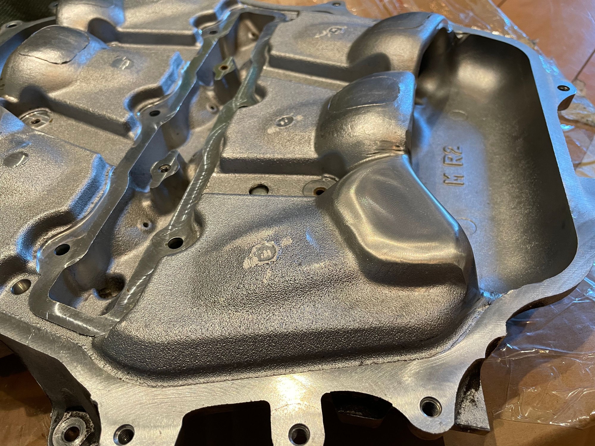

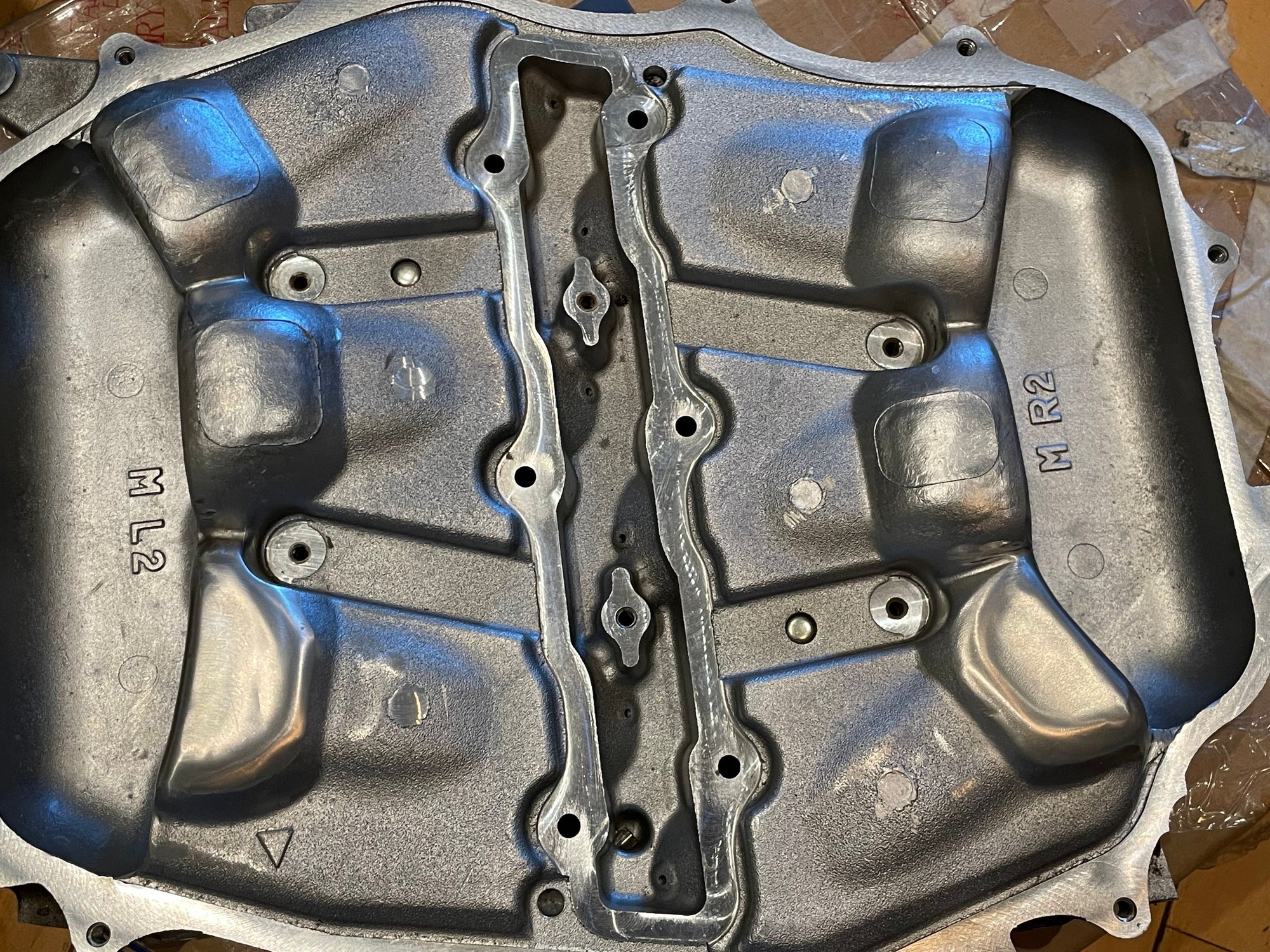

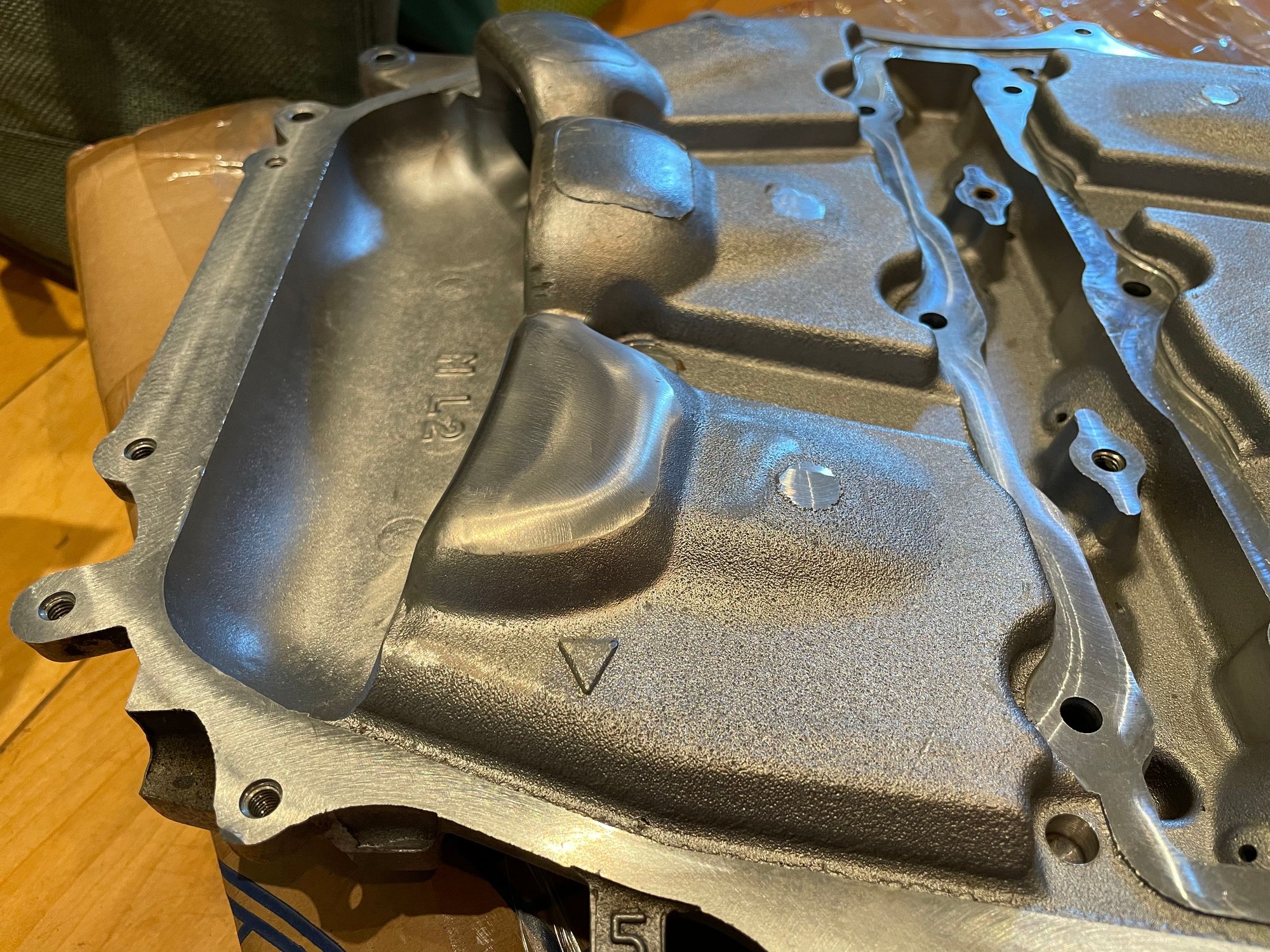

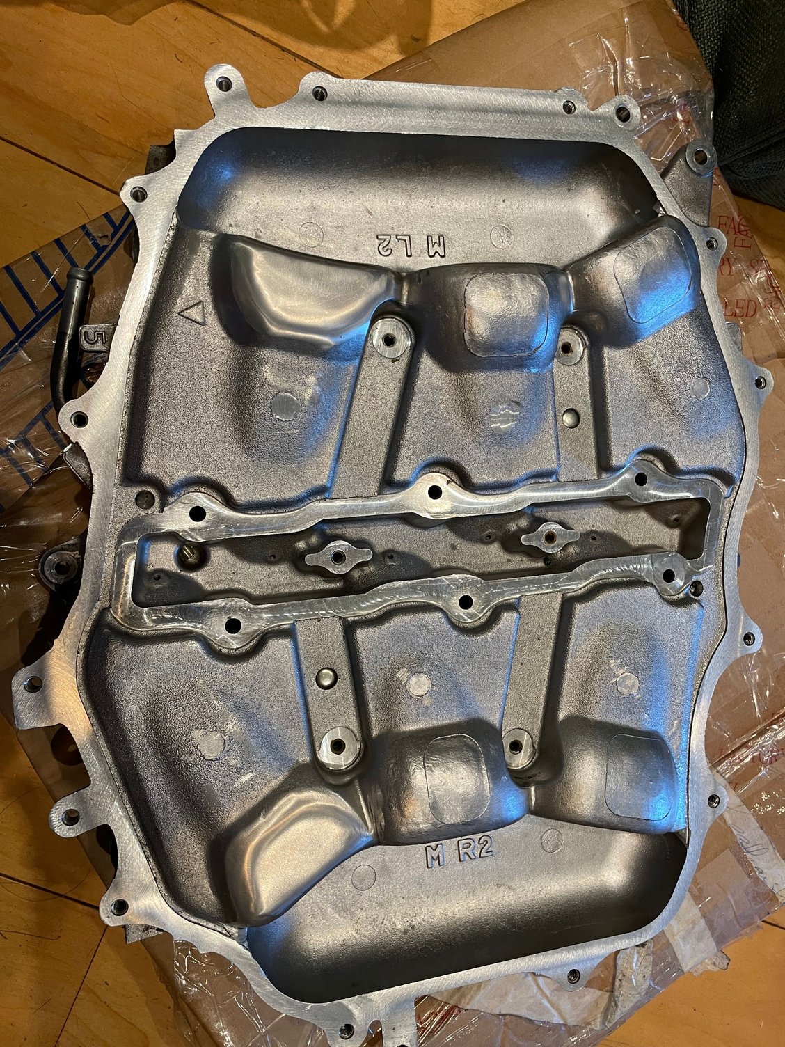

Hi, I have an MREV 2 that I’m trying to verify authenticity for. It’s been a while since I sold my Z so I’m not sure if motordyne is still verifying. Can anyone validate if it’s a real or fake? Thanks

I’m gonna say it’s not real …
I say this because Motordyne doesnt really take that much off if you look at their pictures and I believe they do this work on a mill or a machining / decking machine where you wouldnt get the over-runs, scuffs, cuts into cylinder #3 & #4.
This looks like someone took multiple grit flapper disks with an angle grinder to it …
Just my 2cents
