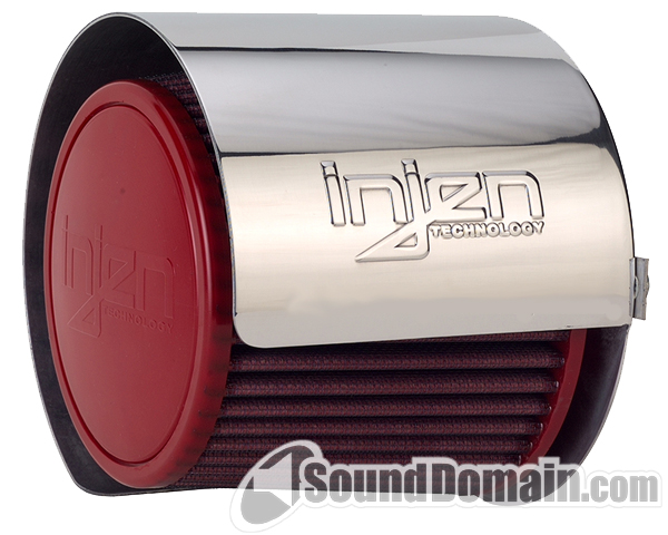

I already did the same thing and used a plastic heat shield I bought at autozone. I also got negativity when I first posted beacuse you were only saving xxx amount of dollars. I did it not only to save money but I enjoyed doing it knowing that i ACTUALLY DID IT MYSELF.

Also, I am using a used stainless steel 2-qt open container from a restaurant supply company as my heat sheild. If this works I will build a 2nd and have it ceramic power coated.
