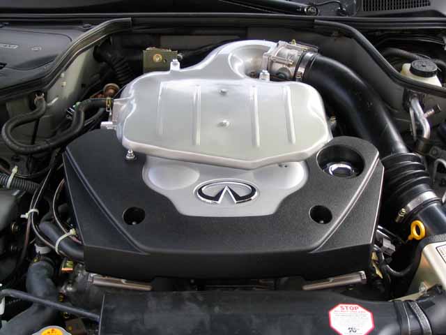

Best plenum - IMO, go with the Crawford. Yes it's more expensive, because you have to give up your stock plenum. But it's the one that has been proven. The kinetix = No hits, no runs, many errors. The Crawford, just plain works.
