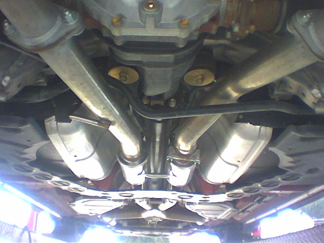

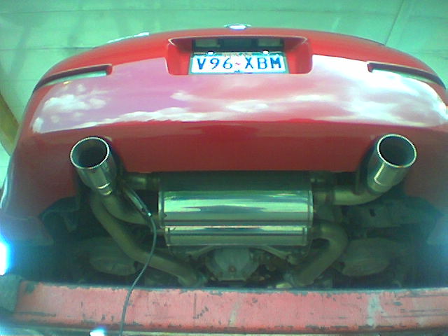

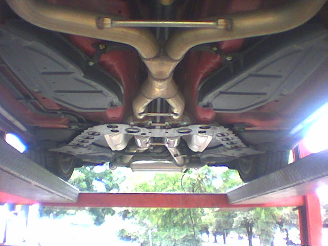

Pictures of exhaust mounted. Sorry it took long. Had to get it up on a lift again.
Attached Thumbnails My Stillen Headers/Exhaust-mountedexhaust2.jpg
Old Jun 22, 2004 | 04:20 PM
chaparro78's Avatar
chaparro78
Posts: 709
From: Keller, TX
some more
front of car looking back
Attached Thumbnails My Stillen Headers/Exhaust-mountedexhaust3.jpg
Old Jun 22, 2004 | 04:21 PM
chaparro78's Avatar
chaparro78
Posts: 709
From: Keller, TX
back of the car forward
Attached Thumbnails My Stillen Headers/Exhaust-mountedexhaust.jpg

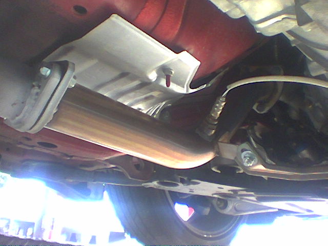

From: Keller, TX

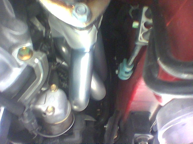

here is the right header
Attached Thumbnails My Stillen Headers/Exhaust-rightheader.jpg
Old Jun 22, 2004 | 04:23 PM
chaparro78's Avatar
chaparro78
Posts: 709
From: Keller, TX
here's the left header
Attached Thumbnails My Stillen Headers/Exhaust-leftheader2.jpg

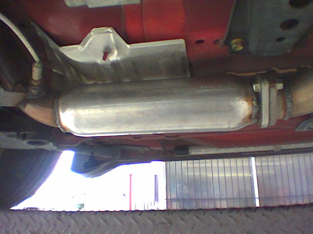

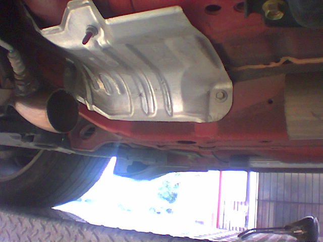

here is the picture of the race pipes - i luv the power but hated the rice burner, raspy, fart cannon sound they made, so i had them modified
before
Attached Thumbnails My Stillen Headers/Exhaust-racepipe.jpg

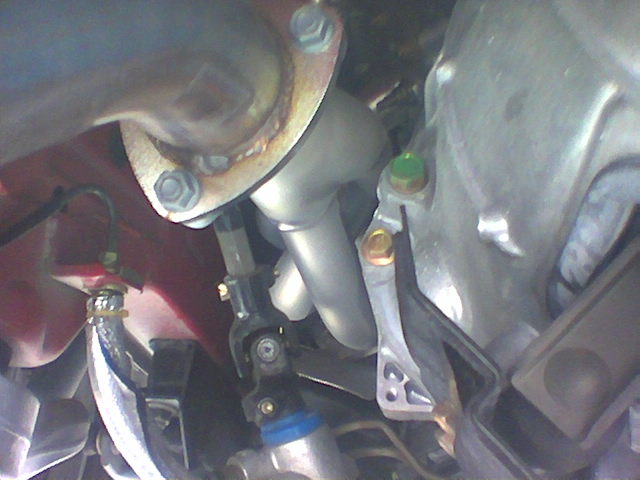

the modification was to weld an in line resonator after the O2 sensor in the racepipe. To do this, some of the racepipe and exhaust were cut to fit the resonator.
Attached Thumbnails My Stillen Headers/Exhaust-racepipeexhaust.jpg

Then the flange is weldes to one side of the resonator and then welded to the racepipe
Attached Thumbnails My Stillen Headers/Exhaust-resonator.jpg

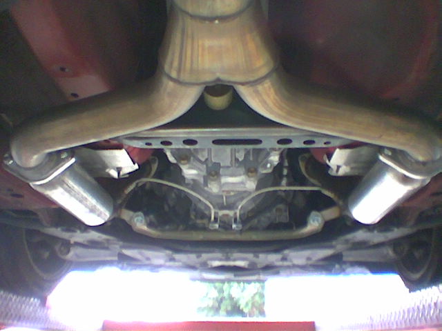

From: Keller, TX
Finished product
No more rasp
No loss of airflow
Same power
Deep tone
The resonators are 2 3/4" on the inside and just over 4" in diameter total
Attached Thumbnails My Stillen Headers/Exhaust-dualresonators.jpg
