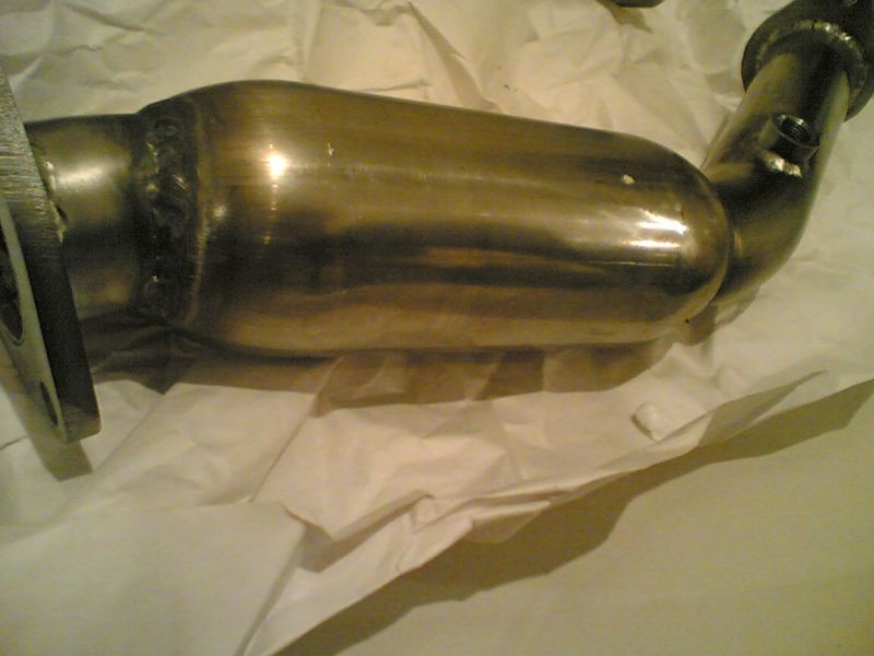

Hmmm, I never new welding on resonators would be such a problem. If the race pipes are already on the car I don't see why a shop would hesitate in doing it considering it was on the car to begin with. All the shop is doing is cutting part of the test pipe and part of the exhaust to weld in the resonators. Neither place I went to had a problem doing the work. One shop said I would have to wait until the next day to get the resonators I wanted. The Shop I had it done at had the resonators in stock so I did it there. Like I said, it took no more than an hour and the work was outstanding. Best thing, NO MORE RASP!!. And you don't lose power

Originally posted by zxsaint
Pull the pipes off the car and take them to a shop and say its for your track-only (race) car. May have a better chance as it's probably only against their rules to touch a street car's cats.
I wouldn't reconmed this because part of the exhaust has to be cut as well. There is only 6 inches of straight test pipe before it hits the exhuast. A resonator is 12 inches. Thats why both the test pipe and the exhuast must be cut. The flange has to be welded to in side of the resonator and the test pipe is welded to the other.

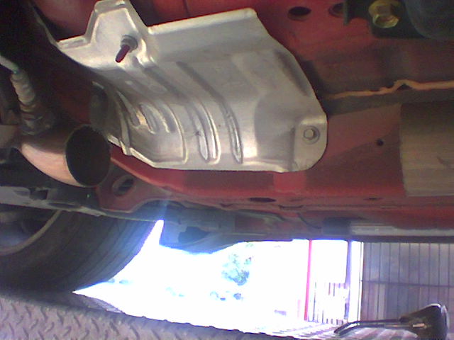

Originally posted by Bahraini350Z
sorry man... but which part are reffering to??

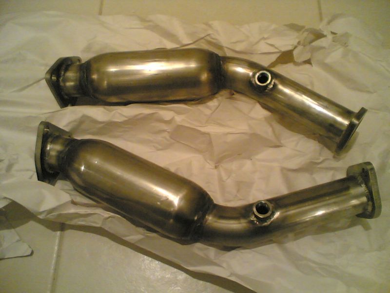

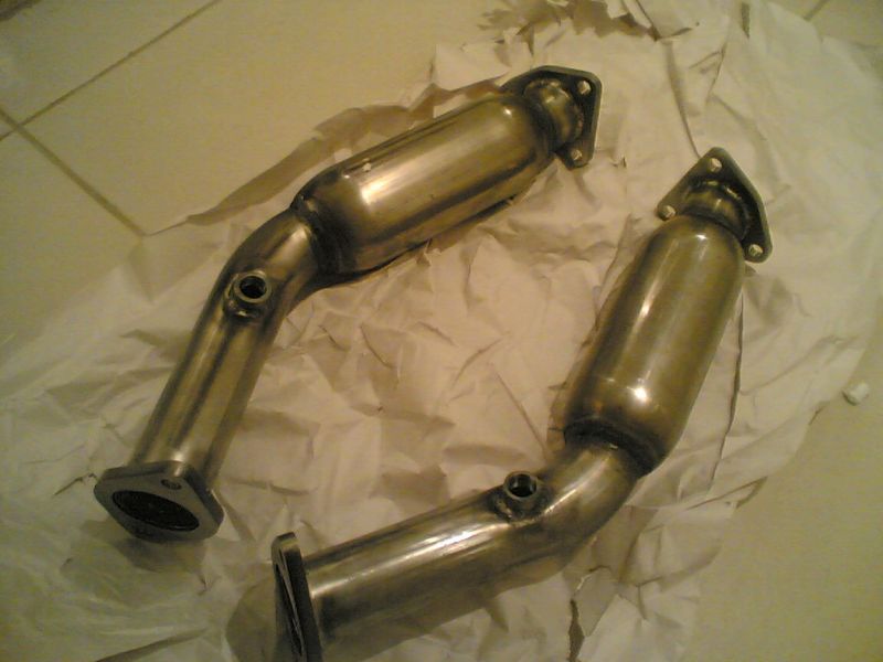

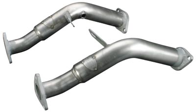

So the stillen race pipes pictured here are resonated?
no i don't think so

Are you sure, it looks like there are 2 different sized pipes welded together in the design which might possibly be a resonator?
