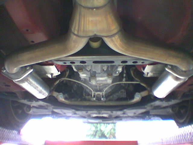

You have four choices:
1. live with it
2. replace them with resonated race pipes or high flow cats
( they will run close to $400 or more )
3. go back to stock cats
4. Do what I did, go to a muffler shop and get resonators installed after your O2 sensors where the race pipes meet the exhaust.
Option 4 is a custom job but less expensive than option 2
Here is a pic of the custom job i had done on my car. Initially I had the same problem, sounded like a fart cannon. But it was nothing some resonators could not fix. And I did not lose any hp due to tighter air flow. I have a thread on the the step by step that was done to fix the rasp problem.
Attached Thumbnails will test pipes change in sound in time?-dualresonators.jpg

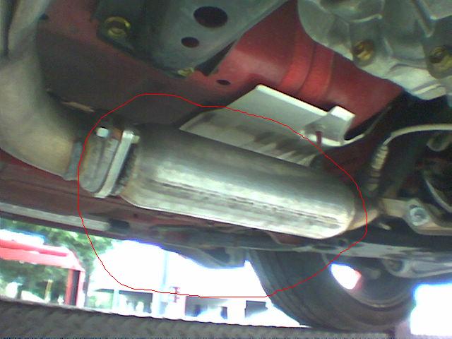

what is a resonator and what does it look like??
Old Jun 26, 2004 | 02:03 PM
chaparro78's Avatar
chaparro78
Posts: 709
From: Keller, TX
This is a resonator
Attached Thumbnails will test pipes change in sound in time?-leftresonator.jpg
Old Jun 26, 2004 | 02:05 PM
chaparro78's Avatar
chaparro78
Posts: 709
From: Keller, TX
Originally posted by booger
When you first posted that you had the resonators welded in .I was jumping up to go have it done .But you would be hard pressed to find a muffler shop around here to do it . The law thing you know .They just wouldnt do it . I have the gutted RT cats and have a extra o2.... 6 inches down line from the stock ones .The only place I could do it , is before the o2 bungs . I think the only way I could get it done around here is to take them off and take just the pipes to the shop .
You can't go to a place like Mineke or Jiffy Lube. You have to find a place that does custom work.
Old Jun 26, 2004 | 02:23 PM
Bahraini350Z's Avatar
Bahraini350Z
Posts: 848
From: Kingdom of Bahrain
Originally posted by chaparro78
This is a resonator
sorry man... but which part are reffering to??
Old Jun 26, 2004 | 02:49 PM
supra crazy's Avatar
supra crazy
Posts: 1,940
From: SoFlo
This Part
