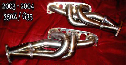

Those DC's are good looking headers, but has anyone tried these BRM headers, they aren't too badly priced either. Are these the same as the nismos?

they look simalar to the Nismo's but those are not nismo headers...
nismo headers look a little beefier...

those dont look like they have the bend to avoid the steering column though...
not good... you dont want to hit the steering column...

Now that you mention it, the left and right side do look identical on the BRM's.

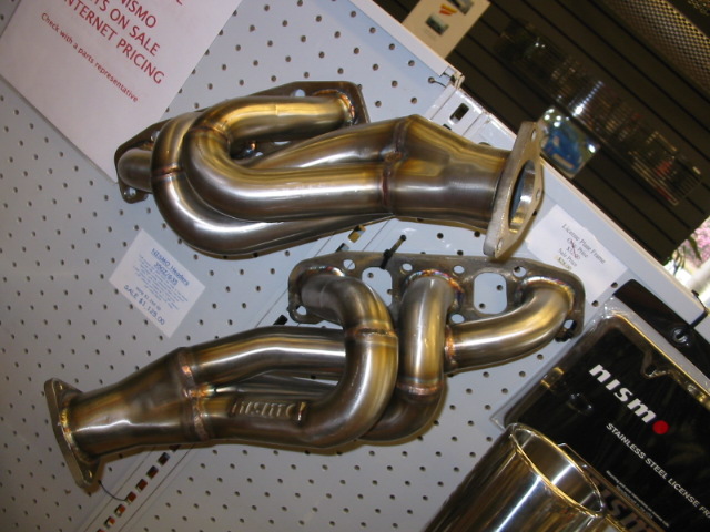

nismo headers (new version with the bigger bend for clearance of the steering column.)

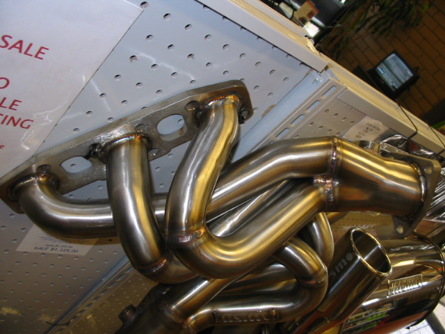

drivers side header...

if you are running the vortech blower I would use the NISMO... they have the largest diamater and longest collector...
