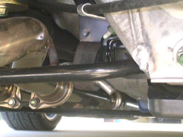

Had rattles too, but thanks to Jason at Performance it's GONE!!! I got from him the ff:
1.) DAT20722AF400 Black L Bracket - same exact one located on the left side, but I did not have one on the right. It pulls up the right pipe & holds it secure.
2.) DAT089111082G Nut hex
3.) DAT20651AA000 Mounting rubber bushing
4.) Flat alum spacers (6) for the black cross member located at the middle of the car underneath the 2 pipes (it needs a 1" clearance) & the spacers prevents it from hitting the pipes.
Now the sound is DEEP & PURE...no rattles!!!

Question
Do you have pics of the fix???? for us to see

Smile injen true dual exhaust (pics for rattle)
Picture of L Bracket on Right side w/ rubber bushing:

Default injen true dual exhaust (pics for rattle fix)
Picture of spacers located on cross member forward of sway bar:

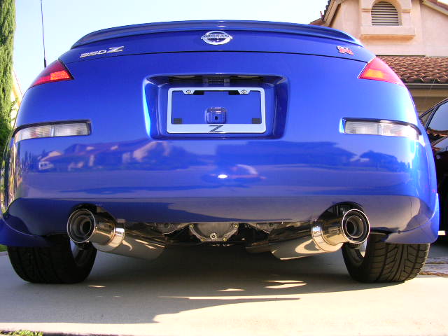

Angled tips:
L Bracket w/ rubber bushing hooked to Right side lifting pipe:

Default .....
is that a gtr emblem?
