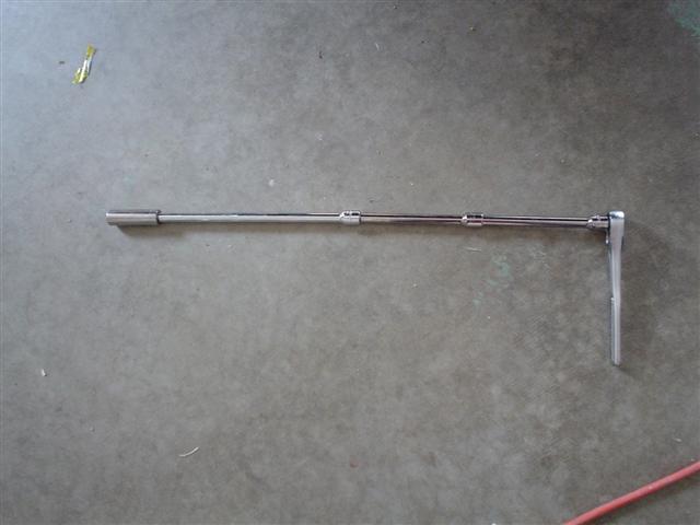

Disconnect the negative battery terminal. Disconnect the MAF sensor and swing the connector out of the way after you remove the intake elbow and airbox. Now take all those extensions and stick them together with the 14mm at the end like so:

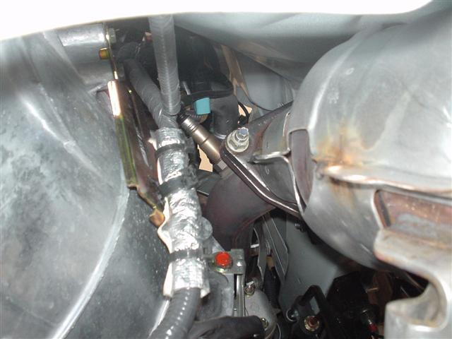

If you look carefully, you'll see the top nut of the exhaust manifold. You know what to do.

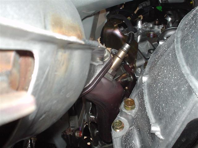

Mosey over to the passenger side and do the same to the top of the passenger side flange nut thing.

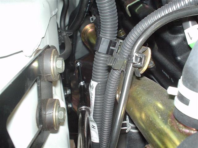

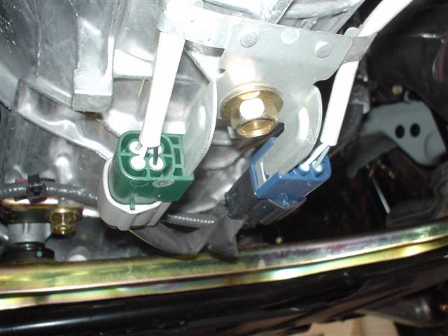

Now, slide beneath the car and disconnect the 02 sensors and slide the connectors off the brackets. While you're down there, loosen all the other bolts related to the exhaust system. Don't worry about the big shiny bar between the two cats, it'll all come out in one big piece.

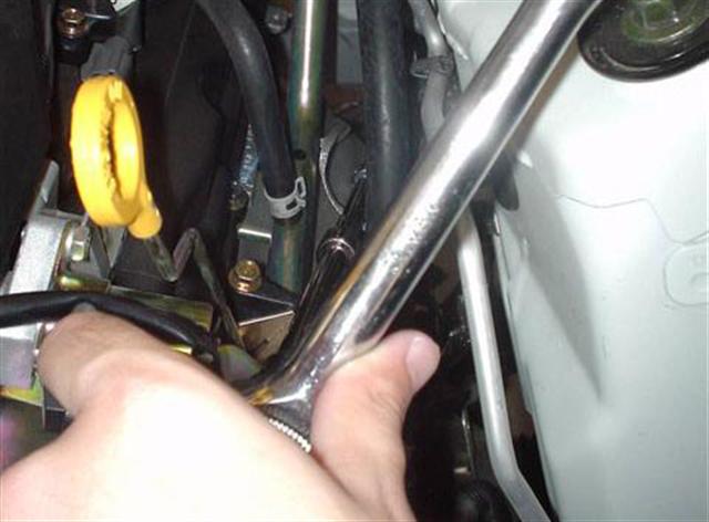

You should see something like this from down there:

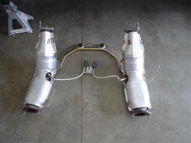

When you get all the bolts out, somehow jimmy out the whole thing. This will pop out of the car:

Take off the gaskets and place them to the side for now. Flip the assembly upside down, and use the 22mm wrench to transfer the oxygen sensors from the cats to the test pipes. Use anti-sieze on the threads. Be careful not to touch or damage the tips of the 02 sensors as they are sensitive and probably expensive.
At this point, put some gasket glue on both sides of the gasket and lay it on. I recommend bolting the upper part up where it meets the manifold because the Y-pipe has a forgiving flex joint. Use a combo wrench on one side and a socket on the other to tighten that tricky upper bolt. Don't forget to use anti-sieze before you put the bolt in. Get the lower gasket for whatever side you're doing, lay on the gasket glue and bolt down until it's nice and tight. Don't forget to use anti-seize and make sure everything is nice and tight.
Do the same for the other side. Reconnect the O2 sensors, thread the wires back into that little bracket on the transmission and reconnect them. Make sure they click into place.
Lower the car. If you didn't disconnect the negative battery terminal before working on the car, then reset the ECU, otherwise the car will run very rich. If you used gasket glue, and you're going by the book, let it sit for a few hours. Otherwise, fire up the car and take 'er for a spin.
