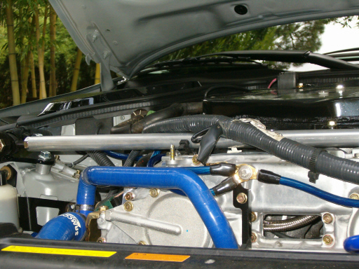

The Crawford plenum and strut bar were installed on my Z last week. I put it on as a safety precaution prior to increasing boost with some custom maps from ACP. No dyno #s yet.

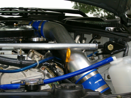

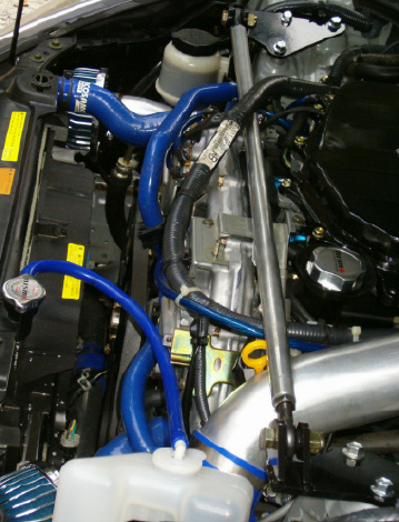

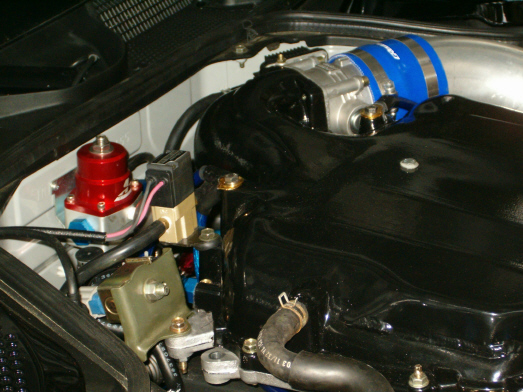

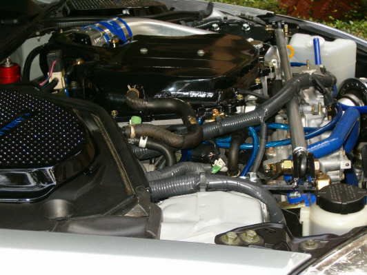

Good deal...my core is on the way back to him now. 3300 miles of TLC. No issues with the strut bar, except whether to position a wiring harness above or underneath it. We chose above, I'll post up some pics later...leaving work to pick her up in a few minutes.

Sweet! So the strut bar fits the Greddy kit? Pics please...

Here they are...running out of time and light

Last one
