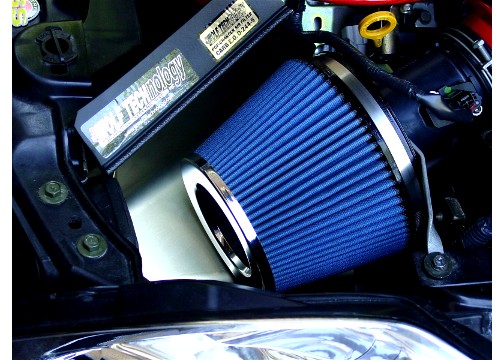

Originally posted by EnthuZiast
Ok...Ill do it myslef!
Do the majority of you think I should just ignore the heat shield?
Definately put the heat shield on.
Easy to install.

I live in AZ so water should not be an issue.

the only thing hard about installing the pop charger is pulling out the old air intake box. I used to think it was getting those two holes in the plastic to hold the heat shield, until I discovered to use a soldering iron to burn the holes thru the plastic - don't try to use a drill, it'll drive you nuts. I never tried using a hole puncher or anything like that, but a simple soldering iron worked great.
