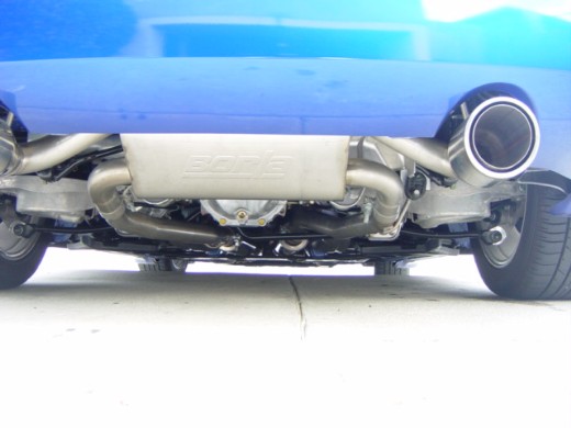

Go with Borla, very similar to stock sount 13 HP Gain. Dynoed proven. Slightly deeper than stock and 2 pipes all the way down, unlike stillen. And you save about 11lbs, where as with stillen you add more weight. 1million mile warranty with BORLA!!!
Again can we please not try to mislead new people or anyone.
The word dyno and proven cant even be used in the same sentence if you ask me!
Anyway to think the Borla will provide you with 13HP is a joke. It sounds throaty...some say American! If you like that buy it.
Problem with the kit IMO is that it is made less effectively. It is a bunch of small pieces put together to make an exhaust. More chances to get an exhaust leak than with others.
If quality is a concern consider NISMO/STILLEN.
If getting 15HP or more is a concern forget about it!

Wouldn't you think that 2 pipes flow more air than one!! You would never think that a dual would flow better than a single pipe, hence better air flow for each manafold, hence more HP>>

There is no True Dual for 350Z...all comes out of 1 muffler!
HMMMMMMMMMMMMMMMM
I respectfully disagree.
Stillen, Injen and HKS (others ?) are true dual exhaust systems in my opinion. Borla does indeed have a common muffler housing. I guess you could argue about Stillen's x-pipe, but it's still a dual system in my book.

When sport z magazine did the exhaust dynos the borla didn't even come close to 13. It made like 5hp or something like that.
Yup Yup that is correct. If I remeber correctly Maserom car is also a AT. I've noticed that AT 350Z's seem to show different gains on the dyno. Why?! Beats me... We used 2 MT's 350Z's for the dyno test
