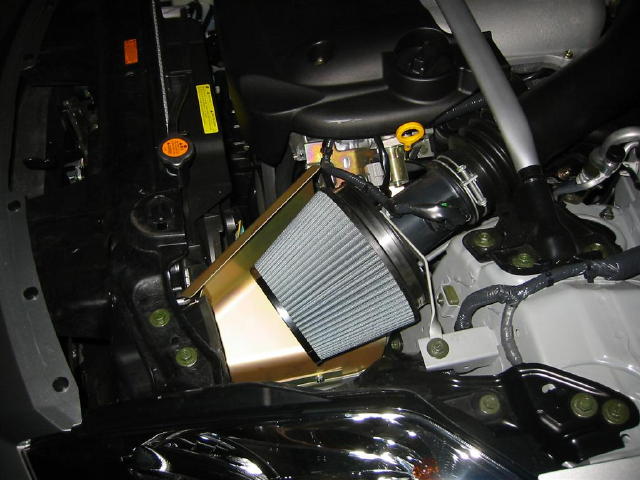

I found this pic in another forum. The owner claims the shield has made a difference. The tip of the filter he says is not hot after driving since installing the shield. He likes the performance and the sound.
Has anyone else installed a pop charger with heat shield and have you noticed a difference as well?
Thanks.
Victor

the rsx has a injen intake out there with a heat sheild. it has been shown to give gains on a dyno vs the same intake without the sheild.

I had this installed (see my pics in the modifications forum). I felt no appriciable difference with the pop charger + heat shield over stock.
When the non-shielded charger was dyno'd and showed a 5hp loss, I decided to take the thing off until I see some dyno results.
It definitely sounds nice though, but until I know its actually giving me a performance gain, I'm not putting it back on.

I have had it on for about 1300 miles with no stalling problems. I installed the heat shield after about 1000 miles and I do belive I feel a difference. It is possible that I lost a couple of horse when installing the filter and now it is back with the heat shield. So in conclusion, I'm back to stock HP...But it sounds cool so I'm leaving it on for now untill a cold air intake comes out.....I am running my car tonight at Raceway Park in NJ so maybe I'll try both ways.....

i have it installed, and did notice a louder grow. performance wise not sure, if its like 4-5 hp gain, is that really noticable compare to the 287. But it sure looks cool as hell once u pop open the lid.

OK, I installed the POP charger after my car was at 2K miles and drove with it for another 1K miles. It sounded GREAT without a doubt! Then, when I got the heat shield, I put the factory airbox back on and drove for 2 days before I went and had my car dyno'd. I had 3 pulls, switched to the POP charge w/heat shield, drove around for 1.5 hrs, and dyno'd it again. Here are the results.
The first 3 pulls varied from 229hp to 232hp w/o the POP charger and 228hp to 234hp with the POP charger. Depending on which pull you compare you could argue that I gained 5hp and an awsome sound. On the other hand you could also argu that I lost 4hp but gained an awesome sound.
I did experience the stalling issue once. What I've come to learn is that if you hold the cluth in (or put the car in neutral) from high RPM's and leave it in long enough to have the RPM's drop to idle, the car WILL stall. But only if that is how you drive. I rearely had this problem.
My conlusion:
Based on the unimpressive Dyno results and the stalling issue, no matter how rare, I currently have the factory airbox installed. I am keeping my POP charger high on a shelf in a nice clean box so that when an ECU is available I can try again to get some power from this Awesome sounding filter.

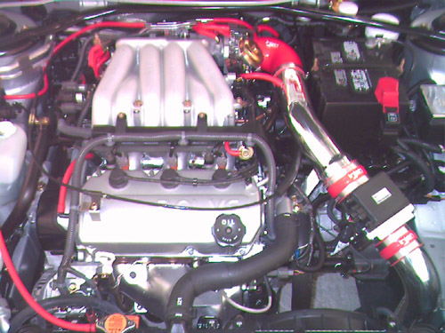

I would reset the ECU after installing any mod. Either by disconnecting the battery at the negative terminal or removing the fuse for the ECU itself. After reconnecting (battery) or reinstalling (fuse) let the car idle for about 15 minutes then drive it fairly hard to allow the ECU to learn the new mod.
I installed an Injen Race Division CAI on my g/f's 01 Eclipse GT and she just could not wait to test it so she drove off and 5 minutes later she had an SES light and some spuddering. She came back and I pulled the ECU fuse to reset. After reinstalling and letting the car idle for 15 minutes then I went and ran the car pretty hard. No more SES, no more spuddering. Have had no problems for 15K miles.
FYI...The MAS on the Eclipse (3.0 V6) is mounted inline with the CAI.
