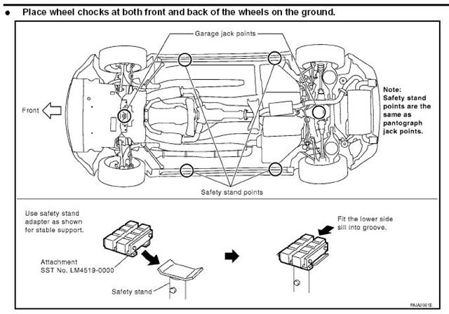

The following diagram may be helpful....

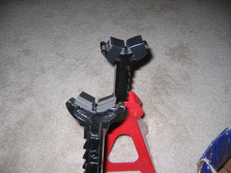

I just got some hard rubber strips from Lowe's, cut them to size, and then stacked them. Worked like a charm. See pic. You want to support the car without putting any pressure on the side ridges.

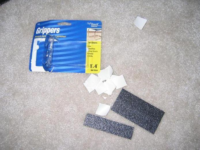

Originally posted by 002-M-P
thanks Jester, i will go to lowes today and pick some of those strips up and try that out...
Here is what the package looks like. Go to the home furnishings section (I can't remember). They are used to keep furniture from sliding on hardwood floor.
