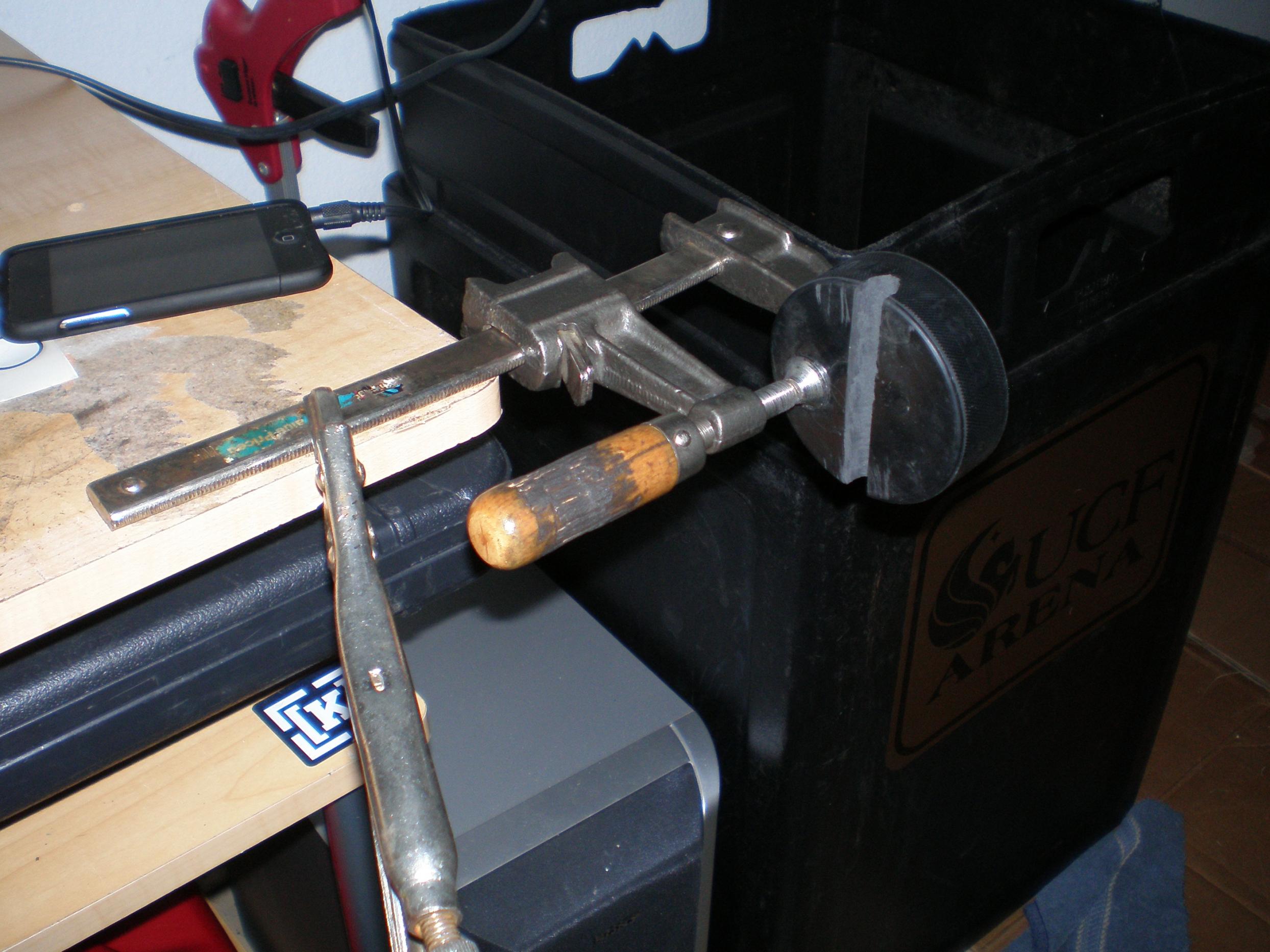

It really simple. And 100 times cheaper than buying that crazy miter saw. Just drill straight down. It literally took me 30 seconds. Then carve to your liking. You could even carve it out to sit flush with a jack stand if you want to get creative with it.
Attached Thumbnails Floor Jack / Jack Stand Adapters-p9231780.jpg   Floor Jack / Jack Stand Adapters-p9231781.jpg
