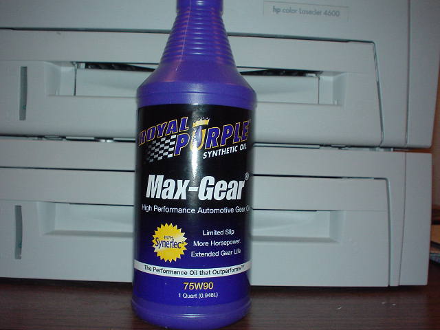

Next time you change your tranny fluid do yourself a favor and
put some of this in...

Where can you get Shell Spirex gear oil?

I've used it, works great for track and warm climates , but Redline MTL/MT90 works much better during cold operation. RP MAX has friction modifiers , gret fro LSDs , not so great for cold Syncros operation.
