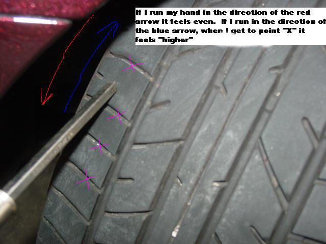

Took some pics this morning with my crappy camera phone...
2004.5 6-speed 13895 miles, 13 months

If you have a loud roaring noise, especially @ 30-35 mph and below, you've got feathering. H@ll, from the pics alone, it appears that way.

really ? i thought in fact the pics say otherwise...

I was looking at the first and second pics. The inside tread blocks appear to be raised on the edges.

yes you're right it does look that way... i drove down an absolutely quiet street after your post, and shifted to neutral and let her roll from 45mph down to 20 and i didn't hear a thing from the front wheels with my windows down... does this mean anything ?

If you don't hear anything then your safe for now. I would keep an eye on them, though.

This is a pic of the front driver's side tire with the steering wheel turned all the way to the left.
If you feel the raised surface at point X, you have feathering.

First they do a new alignment with the latest specs. They also swap the tires right to left.
See this thread to see exactly what they do:
https://my350z.com/forum/showthread....ight=tire+Bonz
Then when you feather the OTHER side of the tire, you then get new front tires. Sometimes if the feathering is so severe, they'll skip the swap and just give you the new tires.

After 36k miles of suffering, my dealer put new tires on front and aligned. Immediately, I took to independent shop and confirmed my dealer's equipment was off, probably was off for the last 36k miles. The independent aligned, and I've driven for 16k miles with no problems.
