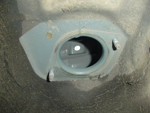

i sheared off part of a bolt that was integrated into an object so I am going to dremel off the remaining part of the bolt, drill through the remaining area and then drop in a replacement and tack/weld it in. I already found a bolt with the same thread pattern, I just need to to be fixed in place permanently.

Can you post a pic up of the object in question. Welding might not be the best option.

yeah, but as soon as i post the pic I become a serious jackass. I wanted to fix it before posting. Anyway, it is one of the bolts that the rear shock goes into above the wheel well. when i was referencing torque specs, i accidently set my torque rench to ftlbs instead of the corresponding newton meters for the bolt so i sheared one about half way off. In any case, there is a little empty compartment above the wheel well where the flex motor sits. I can cut off the broken stud and drill up into the cavity. From inside the car, i can make a cutout that lets me access the cavity, drop my bolt in, weld, then weld the cutout back in place, sand, and prime.
so that is my bone head situation.
ok here is the pic before the break.
just imagine the bolt on the right side of the screen half sheared off.
thanks again for all the help

You may not need to weld the bolt into place. If the stud is spot-welded, the purpose of the weld is just to hold the bolt in place during the mfg process. A bolt just by itself should hold the the shock sufficiantly. Once you get access to the top, take a pic. I should be able to tell wether a weld is needed.

yes, i did. I could not find my camera but I will give the brief rundown. I used the dremel to cutoff the excess bolt. I then drilled up into the cavity through the remains of the factory stud and dropped my bolt through the hole. I used the dremel again to cut into the cavity from the rear of the cabin and set a wrench on the bolt. I had to rig it up to stay on the bolt since i was working by myself. This is where it may have been helpful to tack the bolt in but i was able to get a wrench wedged on the top to hold the bolt and tighten it from the bottom.
So i did something bonehead by reading newton meters as foot pounds and shearing off a bolt but i was able to recover thanks to some help from the forum and a little elbow grease.
