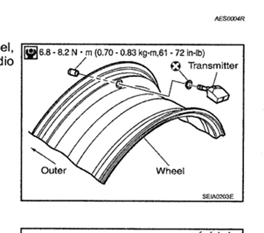

Here is pic of location of monitors

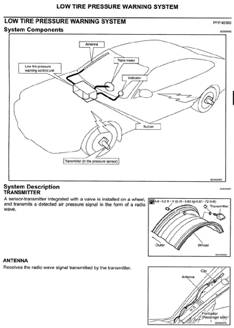

Well, here is the whole page, my guess is that it measure actual pressure. But you wonder if you can buy separate transmitters without having to buy the entire system or if they have to adjust the system, I would think that not all transmitters are on the same frequency, what if you park right next to another Z? Hey, I don't know, I don't care cause I don't have them.

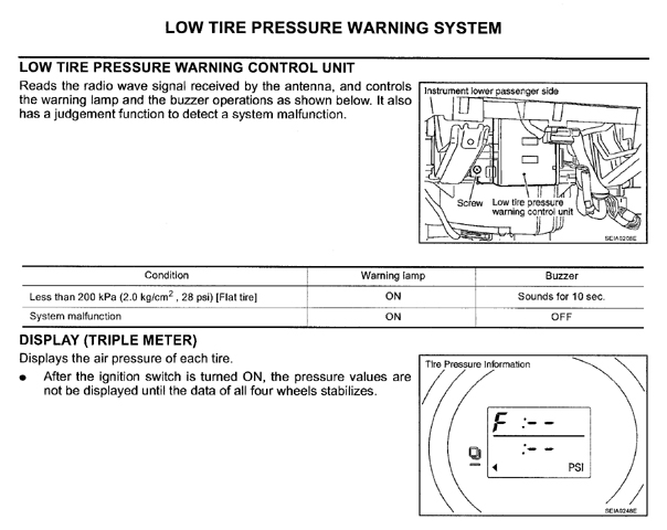

Here is second and last age.
