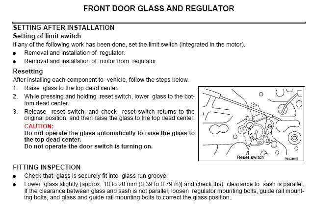

Having some problems with my window motor. Whenever I use the auto up function it closes the window, then lowers it like 3-4 inches. Someone said to reset the motor... how would I do this?
If that doesnt work ill take it to the dealer... but I would really like to do this myself since I dont have the time to go to a dealer just to find out they cant reproduce the problem.

just take it in to get that done under warranty....i don't think they can reset without ordering a new regulator for you. They tried to reset mine but didn't work.

Is this what you were looking for?
